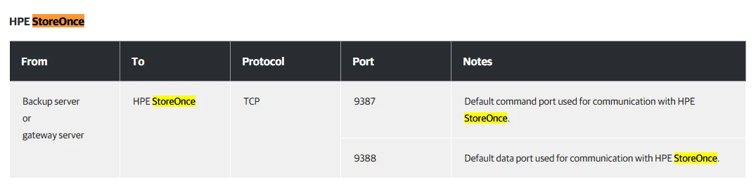

Visit the URL: https://helpcenter.veeam.com/docs/backup/vsphere/used_ports.html?ver=120
waqasali
Forum|alt.badge.img+4
  • On the path to Greatness
  • November 10, 2025
can you please ellaborate where to set ports on veeam side and how to know storeonce vsa is opend to which port
port should be open from the FW side check the required things example below:
in addition to check from VBR server in poweshell
Test-NetConnection -ComputerName ? -Port 16022
Check firewall rules on both VBR VM and StoreOnce VSA.
Use telnet <StoreOnce_IP> 16022 or Test-NetConnection in PowerShell to verify connectivity.

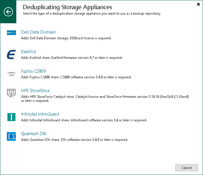

Based on the port you’re referencing, it looks like you’re trying to add an HPE StoreVirtual storage appliance via the storage infrastructure tab.
Instead, you should be going to the Backup Infrastructure tab, to Backup Repositories, and add the StoreOnce as a repository. It will show up under Deduplicating Storage Appliance
