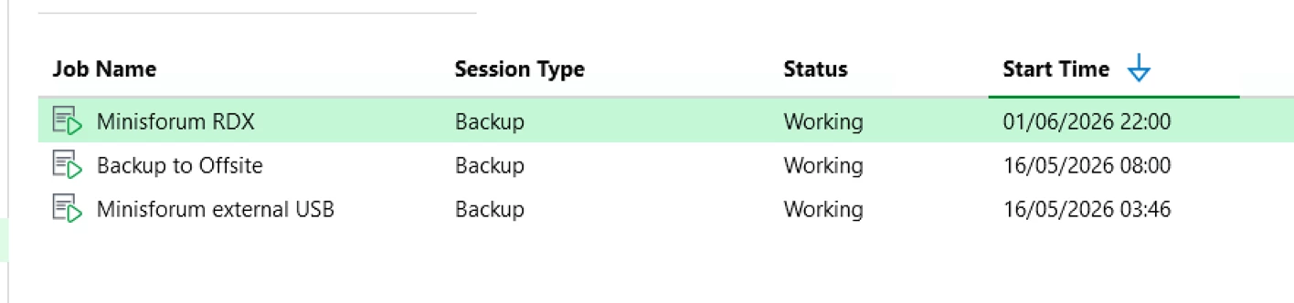

Hi,
I noticed that I have two running backup jobs since mid May and it appears they are stalled. From the same job I get success emails each day. It appears the backups job were running fine at the scheduled time. Kind of overlap.
Maybe the stalled job are leftovers when I upgrade my VBR to 13. I’m not sure.
I shutdown the server twice and the stalled jobs reappears. I can right click on it and press stop, but even after hours nothing happens.
How can I get rid of the running instances?
I enclose two screenshots
Thanks,
Edy

What if you disable the jobs and then reboot the server to see?  After that, if they are not running, enable them again.  If the issue comes back, would suggest a support ticket for them to troubleshoot the issue.

My first thought is stale job session, possibly in the config DB after updates. You may have some luck with PowerShell vs the GUI. - Get-VBRJob -Name "Your Job Name" | Stop-VBRJob -Confirm:$false
Otherwise what others have said makes sense. Disable jobs, reboot. Re-enable after start if the stale sessions are gone.

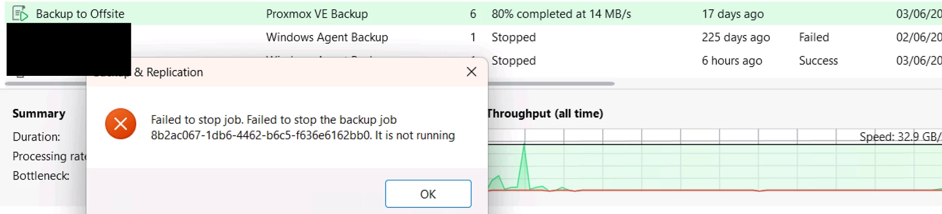

Thanks for the fast replies to everyone. In Powershell all jobs are in stopped state and everything looks fine. Just the GUI still shows them even they are disabled now and I rebooted the server.
This is an NFR license and I don’t think to received support.

​@Edy - yeah..that’s why I suggested probably best to get ahold of Support. The error you showed in your screenshot shows the Job is stopped, but the GUI is showing something different. Honestly, I think Support is your only route.

​@Edy , let’s hope Support has bandwidth for an NFR case -- the issue is a problem in the configuration database, that particular job session likely didn’t get closed out correctly, and usually requires manual intervention. This is purely an aesthetic matter, no processing is actually happening for the job, the session just was never told to stop so the counter continues to increment.
For your case in particular, if Support doesn’t have the bandwidth to take an NFR case, you can try the following:
  1. Take a fresh configuration backup
  2. Stop all jobs and tasks
  3. Start a Configuration Restore from the configuration backup you made in step 1
The Configuration Restore has some clean-up activities for situations like this and you might be able to resolve it.
IMPORTANT: This is not a solution for a production server, as Configuration Restore has quite a few considerations -- it is not destructive, but it will interrupt backup operations, potentially for quite a long time. For a production backup server, a Support Case is a must.

To close this out, regrettably there was no bandwidth for handling this Community Edition case.
Worked with Edy and was able to resolve the eternally running sessions another way, but the solution is not safe for publication.
If you have a similar issue, you must open a Support Case and allow Veeam Support to review the situation.
