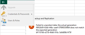

VBR Migration to New Server Error when accessing User and Roles.
Did a test migration from an old VBR to a new server. Most functions and configuration migrated successfully, just need to re-enter credentials for the cloud, storage (NAS and immutable). Backup jobs are also running successfully and configuration backups are working. However when I went to Users and Roles, I got the error below, “Failed to unprotect data:…..”. I thought initially, it was just the encryption so I enabled but still get the same error.
What is causing this issue? Thanks.

How did you do the migration? With the configuration restore?
The error is about Veeam being unable to decrypt the secrets in the configuration database -- Veeam uses a salt for a few versions now in addition to the machine key on the original server to encrypt secrets in the database -- if the database was migrated manually (i.e., just moving the database files), this will not work as the salt + machine key are not included this way, and the new server cannot decrypt the secrets.
Use this process only to migrate the VBR server to a new server: https://helpcenter.veeam.com/docs/backup/vsphere/vbr_config_migrate.html?ver=120

I did not manually moved the DB. As pointed out, I have followed the instructions on https://helpcenter.veeam.com/docs/backup/vsphere/vbr_config_migrate.html?ver=120.
I opened a ticket with support a couple of days ago and we’re still figuring out the issue. We will do a remote session and will update you folks.

Support gave me a cmd to run in pgadmin. It basically resets to null the column secret in the backup.security.accountmfaprofile table.
update "backup.security.accountmfaprofile" set secret = '';
