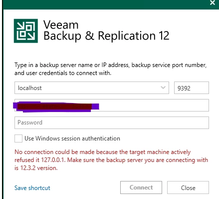

We are facing an issue with VBR where the application is down and cannot connect to the backup server.
The error message shown is:
“No connection could be made because the target machine actively refused it 127.0.0.1. Make sure the backup server you are connecting with is 12.3.2 version.”
Has anyone encountered this issue before? What steps or permanent solution can resolve this? Any guidance would be appreciated.
