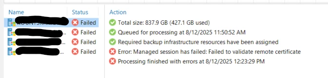

Hello,
we have been used company certificate into VBR console in main menu …
but now we have issue with agents managed by VBR
8/10/2025 10:44:54 PM :: Error: Managed session has failed: Failed to validate remote certificate
any hints, how to fix that I will appreciate

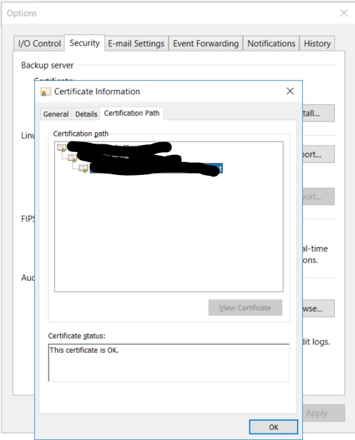

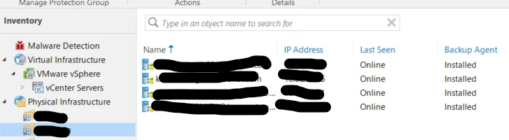

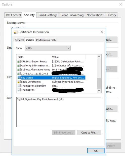

Where in the VBR console are you able to put a screenshot?  Did you try editing the managed agents to go through the wizard to accept changes to the SSL?  More information is needed here as I don't recall using a custom SSL in VBR, definitely in VEM yes.
Marcel.K
Forum|alt.badge.img+13
  • Author
  • Veeam Legend
  • Aug 12, 2025 1:02 PM UTC
Certificate installed on VBR
Agents managed by VBR
Job failed
with self-signed it was fine
Chris.Childerhose
Forum|alt.badge.img+23
Again try to edit the Agents and go through the wizard to see if there is a popup about trusting the SSL.  I assume these are managed agents?  Otherwise you might need to revert the SSL to get it working then open a ticket with Support for further help as to why this fails.
