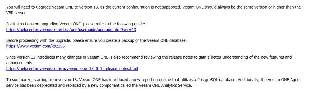

Confirmation email:
I will prepare plan and implement asap. thank you guys for your comments.
