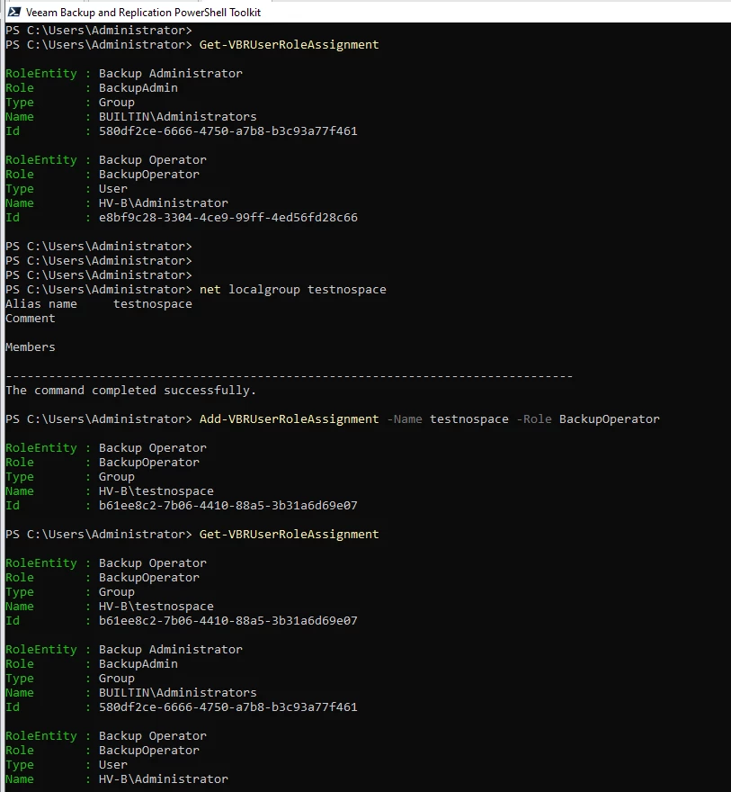

​@NeonFrog
With the recent release of Veeam Backup & Replication v13.1, I decided to revisit and retest this behavior to determine whether it is still an issue.
Good news it's no longer a problem
Retesting results
