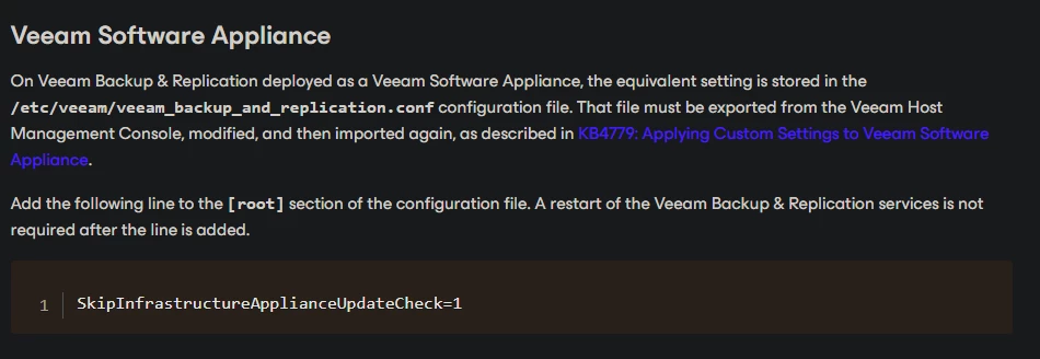

There is a registry key also that you can add that turns off the check for updates on the VSA which might allow you to add the VIA to it.  Check this KB - https://www.veeam.com/kb4916
There is a section there for Veeam Software Appliance and you need to update the veeam_backup_and_replication.conf configuration file to add the setting.

Unfortunately this registry key doesn’t solve the issue, so adding the VIA will still fail with the error above.
