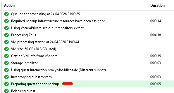

Michael Melter
Forum|alt.badge.img+12
You say you have “Enable Application Aware Processing” ticked in your job. Did you check if it actually does do that? What do you see in the job log? Any errors/warnings for the VM?
Do you see indication of application aware processing kicking in and being successful?
If VSS is broken/stopped on the DC, you would find out here
