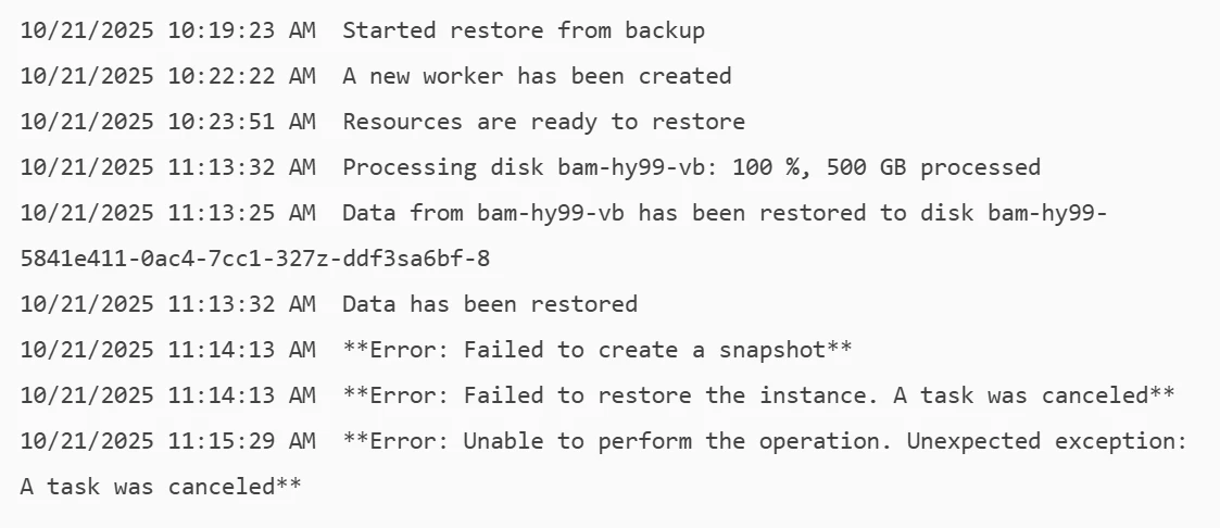

I’m performing a restore process in Veeam Backup for Google Cloud and encountered an issue after the data restoration phase. Here are the key log details:
The disk restore completed successfully, but the instance restore failed due to snapshot creation error.
Question:
  • Has anyone faced this issue in GCP restores?
  • What could cause snapshot creation to fail after disk restoration?
  • Any recommended troubleshooting steps or permissions to check?
