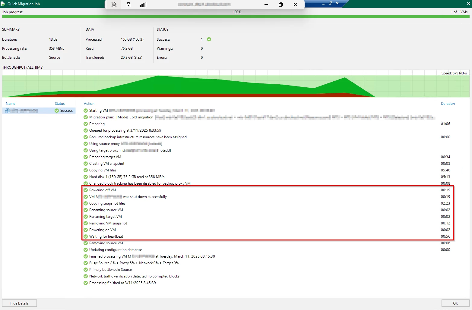

​@Nikks Yes, cold migration will cause downtime because the VM must be powered off before migration and VM will be inaccessible until the migration is complete and the VM is powered back on in the new environment
Quick Migration retains the original UUID and backup chain remains intact. Since the UUID is preserved, Veeam will continue incremental backups without treating the VM as a new entity.
As ​@lukas.k  said, estimated time depends on the performance on you infrastructure such as network speed and host resources and size of the VM. Since the VM files are remain on the same datastore, for cold migration it depends on how quickly the VM can be powered off and registered on the new vCenter.
vMotioning VBR server should work fine. As a precaution, take a configuration backup before performing the migration.
