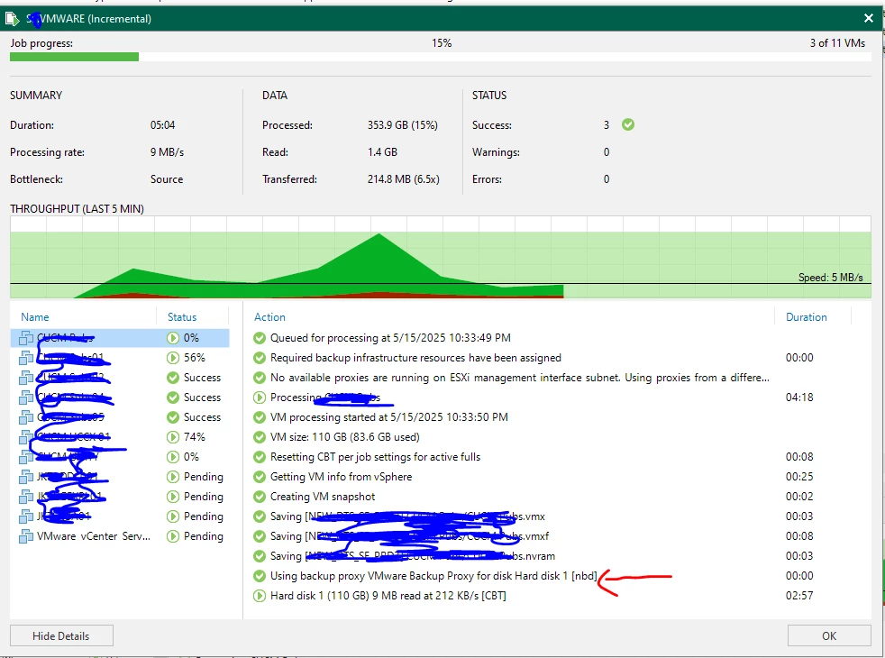

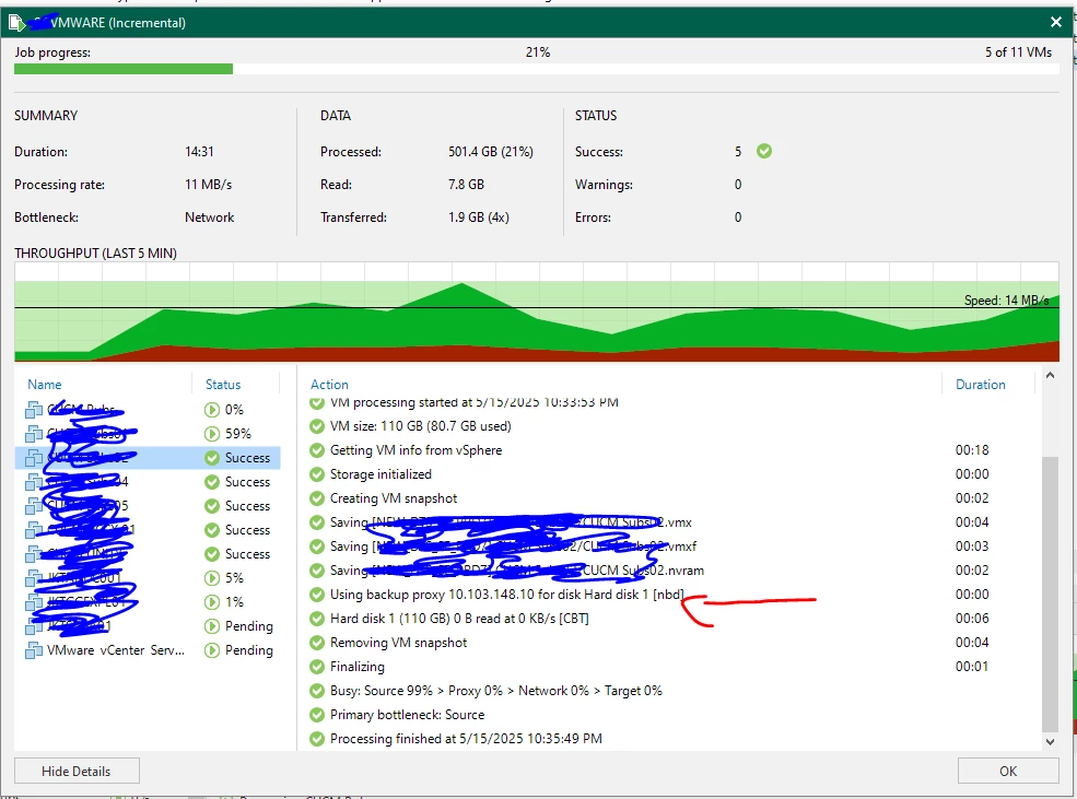

I have single vmware backup contains 11VMs. In the details why there are 1 VM using default proxy and the rest using custom proxy? With this situation the 1 VM have slow backup.

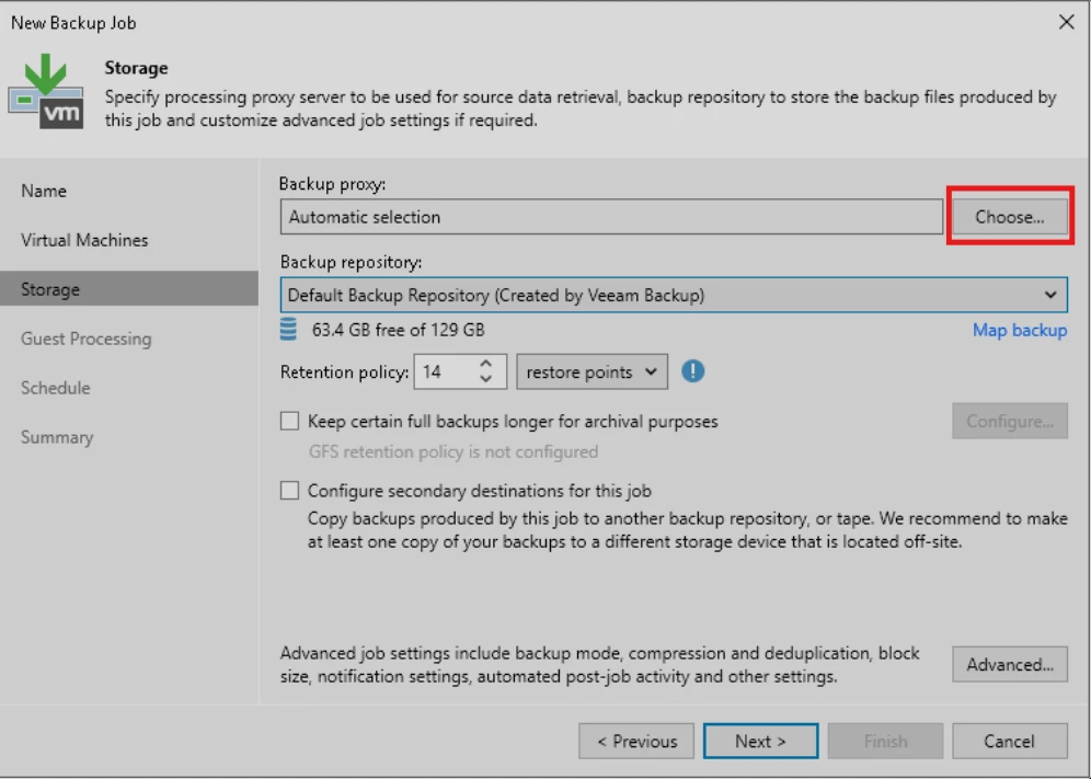

Based on your screenshot, it looks like both are using NBD. That means that at the time of proxy selection, the proxy that was selected had more free tasks than the other proxy. If you don’t want that proxy being used in that job, you can force it to use certain proxies here:

Veeam will assign tasks based on multiple factors. Here’s what I found in the forums:
For each VM in the job, backup server classifies all backup proxies available to the job into 3 groups by access type they have to the VM's disks: SAN (1), hot add (2) and network (3). Proxy with least tasks currently assigned is picked from group 1, and if responding, VM processing task is assigned to this proxy. Otherwise, the next least busy proxy is selected from group 1. If all available proxies group 1 are already running max number of concurrent tasks, selection process switches to group 2 and repeats. Group 3 is only used if groups 1 and 2 have no responding proxies. For group 3, proxy subnet is also considered when picking the best proxy.
Also, check to see how many concurrent tasks you have set on the “VMware Backup Proxy”

hi ​@Tommy O'Shea
it’s work after i set manually the proxy in job setting.
