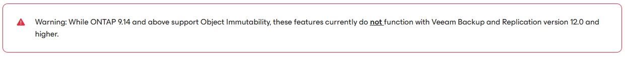

NetApp ONTAP S3 with Immutability (ONTAP 9.14 and higher) is currently not (or no longer) supported by Veeam. This means that Veeam backups on a NetApp ONTAP S3 bucket with activated Object Lock (Immutability) are currently not considered “immutable” in the sense of Veeam functionality.
The main reason is that ONTAP S3 with activated Object Lock no longer fulfills all the requirements that Veeam needs for immutability.
Veeam currently only lists ONTAP S3 as “not immutable” in its own compatibility directory. The use of Immutability is therefore not officially approved
NetApp is working on a solution with the support of Veeam (you may be able to get information via the NetApp Partner Manager).
--> This is ONTAP S3 (on ONTAP machines (FAS/AFF), not a NetApp Storage GRID)!

For clarity, the article you are referring to https://www.veeam.com/sys539 does not list immutability as a feature and attribute. This is the same case for many other vendors. There is no reason to create a post here about each article, as the article could be updated with revised information at any given time if a vendor re-runs testing and passes the tests successfully.
As an example, the article was updated in May to reflect the following text: Warning: While ONTAP 9.14 and above support Object Immutability, this feature has never been tested successfully with Veeam Ready and currently does not function with Veeam Backup and Replication version 12.0 and higher.
However, that doesn't match with your screenshot in the article.
The text “no longer fulfills” is also misleading. It was never tested for Veeam Ready. I’m not sure exactly where you got this information, but it makes it sound like it was fulfilling the requirements and now does not, which is incorrect.
