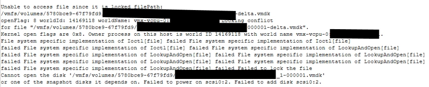

I tried to attach the vmdk based on this KB article and got the following error:
I find Veeam’s article to be accurate so just checking if I miss something.
I have a backup job that fails using hotadd so trying to isolate where the issue is.

When you go to attach the source VM disk ​@spider32 , you attach the PARENT/base/original disk, not the snapshot. Is that the process you’re doing? Again..worked for me. From the log you shared (not sure where you got that from..vSphere?)..looks like you were trying to attach the snap disk and not base/parent disk.
Go through the 2 links I shared...from KB1184...and make sure your source VM is supported. If you have snapshots on it currently, make sure to remove them first before doing the test so you have a ‘clean’ source VM.
