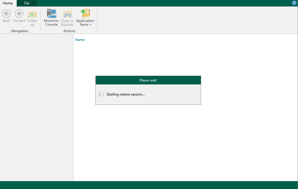

Hello Veeam People,
I have problems with opening Guest File Restore from Backups.
I’m trying to configure some restores for our Revit Server scenarios.
The problem is that I choose which point I want, proced to browse the files and then I’m stuck with the following popup window:
What can be the issue here, I checked the Mount Server, it’s the VMs where our Repos are connected via iSCSi.

Hello ​@coolsport00 ,
Previous week I manage to open backup pretty fast, but after that, every other tries just “loads” it forever. Even 2 days and still nothing.

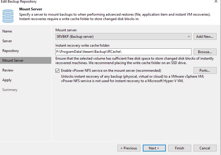

Mount Servers are configured on the Backup Repositories settings?

Yes, you should edit the pool used in the job and change the “Mount Server” option.

Problem is that our mount servers are the Windows Server VMs acting as a backup repository.
Storage (Synology NAS) is attached via iSCSI, formatted as ReFS with 64kb. It doesn’t want to mount the disk, don’t know exactly why.
When I tested with reconfiguring the mount server to a Hyper-V Host without any iscsi storage etc, it worked.
Are there any configurations that we can do to make it work since our Backup Repos have the amount of free space to restore some files.
