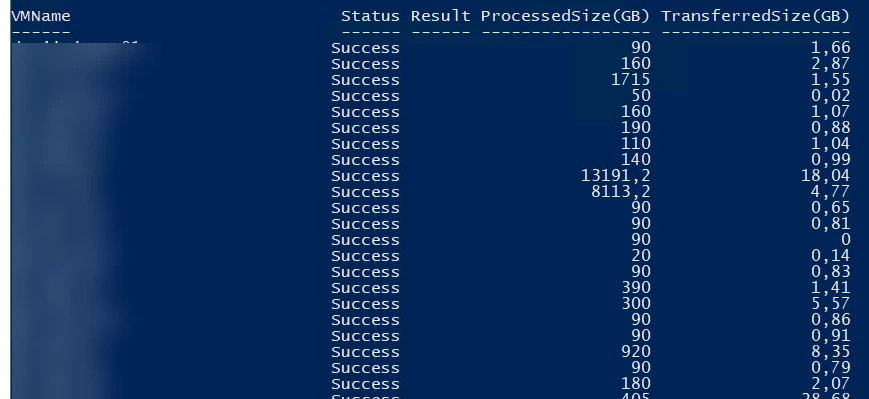

I have single veeam backup policy with contains of 10 VMs.
How we can get backup status for each VM to knowing the VM is backup is successful or not using powershell?
Best answer by Dynamic
After asking ChatGPT again and tweaking the output to this….

you will get this:

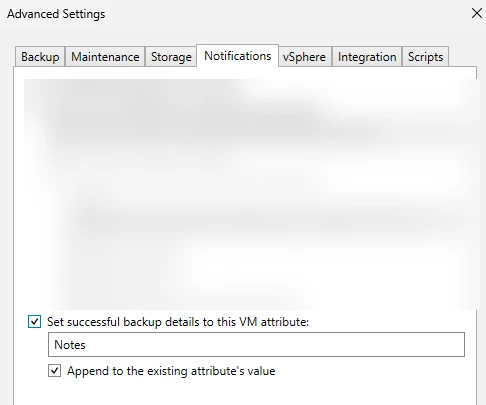

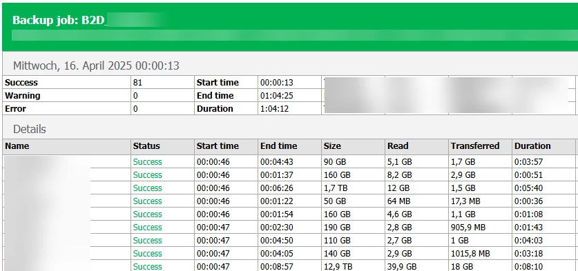

Hi ​@hs08, don’t know if i get you correct (if you want to use/or not to use PowerShell), but:
  • you can see the state within the job result itself
  • you can check within the History section
  • you can receive a report by mail - this will list all protected workloads (so in your case 10 VMs)
  • you can use Veeam ONE and/or Enterprise Manager to track state of your jobs.
  • you can track the details within vSphere of the VMs (as an attribute)
  • depend on your Monitoring solution, this solution could track this maybe as well.

Below some examples (within VBR)…
# Load Veeam PowerShell Snap-In
Add-PSSnapin VeeamPSSnapIn -ErrorAction SilentlyContinue
# Job name
$jobName = "NAMEOFYOURJOB"
# Get the job
$job = Get-VBRJob -Name $jobName
if ($job -eq $null) {
Write-Host "Backup job '$jobName' not found."
return
# Get the latest session of the job
$lastSession = $job.FindLastSession()
if ($lastSession -eq $null) {
Write-Host "No sessions found for job '$jobName'."
return
# Get all processed VMs in the last session
$sessionObjects = Get-VBRBackupSession -Id $lastSession.Id |
Get-VBRTaskSession |
Where-Object {$_.Info.Progress -ne $null} |
Select-Object @{Name="VMName";Expression={$_.Name}},
@{Name="Status";Expression={$_.Status}},
@{Name="Result";Expression={$_.Info.Result}},
@{Name="ProcessedSize(GB)";Expression={[math]::Round($_.Info.Progress.ProcessedSize/1GB, 2)}},
@{Name="TransferredSize(GB)";Expression={[math]::Round($_.Info.Progress.TransferedSize/1GB, 2)}}
# Output
$sessionObjects | Format-Table -AutoSize
you will get this:

Hi ​@hs08 ,
there is also a finished reporting script available on Github called “MyVeeamReport” maybe this could help.
https://github.com/marcohorstmann/MyVeeamReport

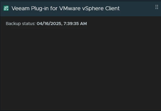

Further to what everyone here has said if you want a very quick way to check then you can install the vSphere plugin from Enterprise Manager and it will show you at a glance if your VM is backed up.
