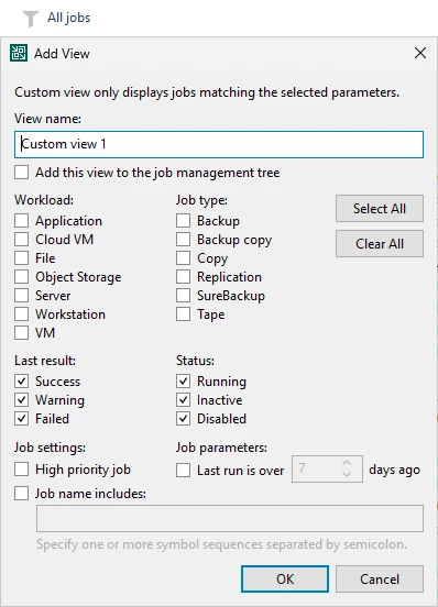

You can create filtered views, e.g. selecting “Application” workload would only show plug-in jobs, etc. You can’t filter by schedule (like daily/weekly/...), though.

Hey ​@MattM
I already found the filtered Views, but that’s not exactly the Thing I was looking for. But thanks anyways!
