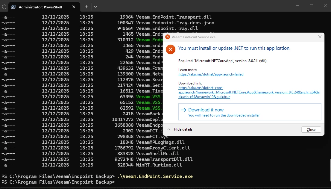

I had this problem today after uninstalling Visual Studio where it seemed to strip away the .NET runtime causing the Veeam Agent to error. And for some reason running the Veeam Agent installer again did not reinstall .NET runtime. Odd.
Just to say that version 13.01.1009 (latest as of today) now depends on 8.0.24. If you run the service manually you get this pop up if the .NET run time is not installed. As soon as I downloaded it from Microsoft and ran it, Veeam Agent started working again.
