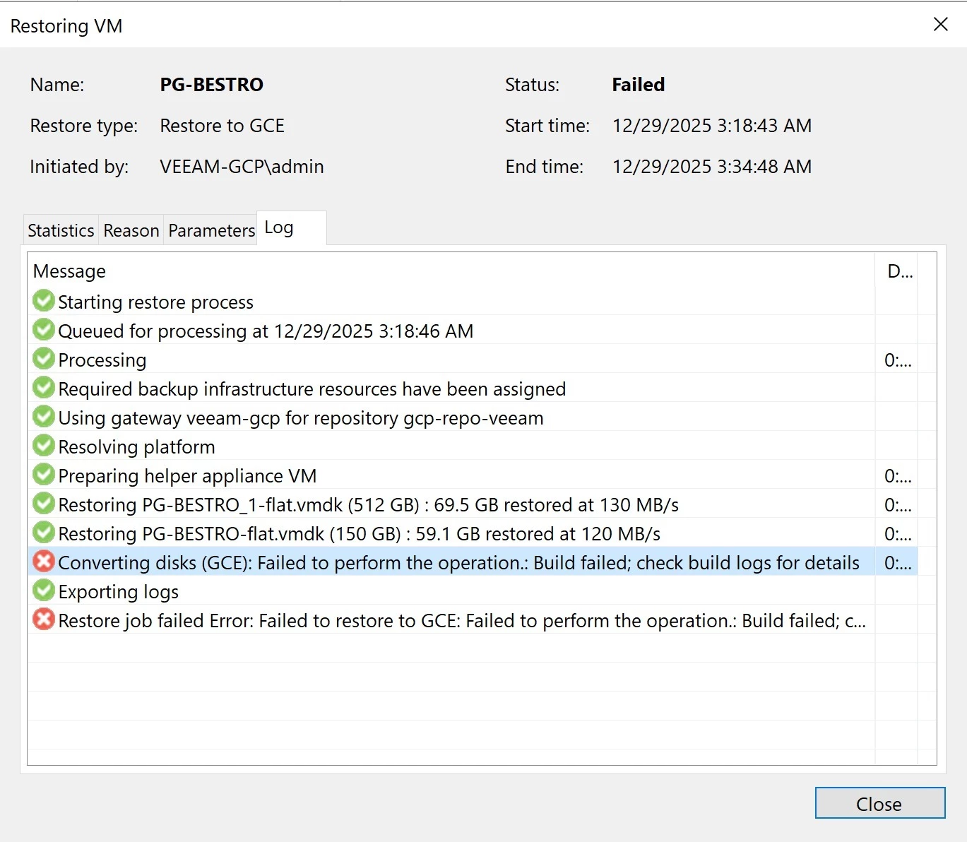

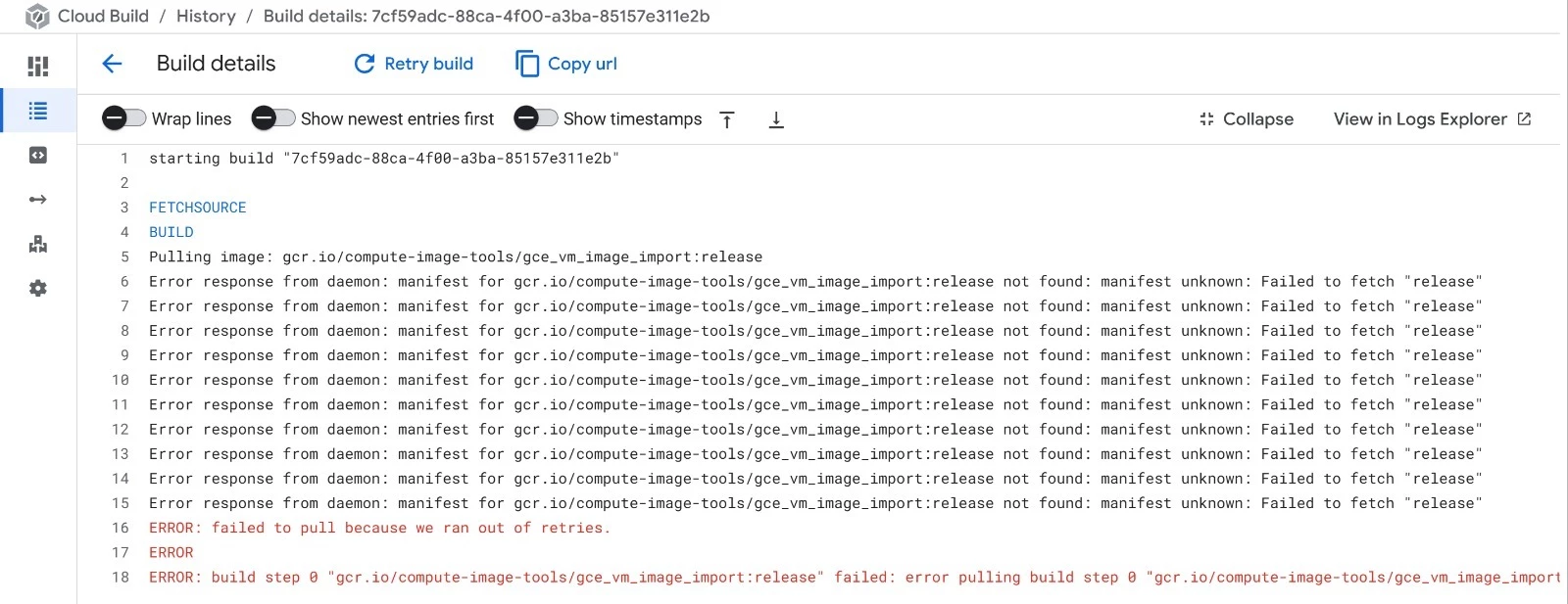

hi, im using VBR 12.3 deploy on GCE on GCP, I have succesfully backup and storing on GCS and i want to restore into GCE, and finnally failed, i consider VBR using Cloud Build to atomate restoring. the same log from VBR log and Cloud Build History. I think GCP not using GC, now using Artifact Registry, and i checked the image import link, its totally empty. any suggest in this case? the same case i using VBR 13.

Hi ​@coolsport00 , there’s misunderstanding. This Product not VBGCP like these link. I’m using Veeam Backup and Replication ver13 run on top Google Compute Engine (VM) that backup from VMWare On-premise into Google Cloud Storage, and there’s 2 VBR Server, OnPrem for backup and GCP for Restore.
