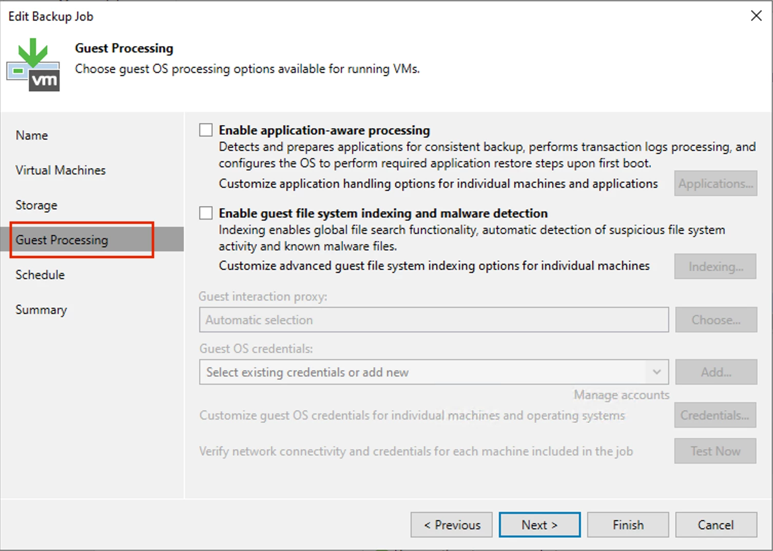

@Tommy O'Shea - well, I use Guest Processing interchangeably to mean both because they fall under that named section of the Job wizard.
Guest Processing
But agree...to mitigate confusion is probably best to be specific.

@CPI - ok; and..to be clear...AAIP can be enabled, but you really don’t need guest indexing enabled. If you disable that and run the job..see if it then is successful.

Yeah I created a new backup job for just the DC’s and enabled Application Aware Processing but not Guest Processing. I kicked off the job when the wizard ended and it successfully completed the backup within a few minutes. Would still like to know why this occurred only after a OS upgrade on DCs and no other servers but not something critical to know.
