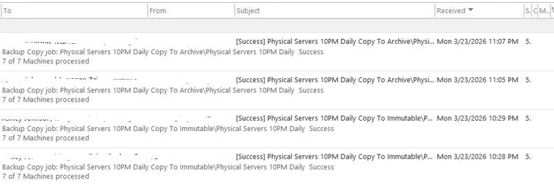

The copy backup jobs (secondary target) for two of physical server backup jobs are generating two emails per backup instead of one.
For each backup copy job run,  two “Success” emails within minutes:
Example:
  • 11:05 PM – Success
  • 11:07 PM – Success
 Subjects are identical,

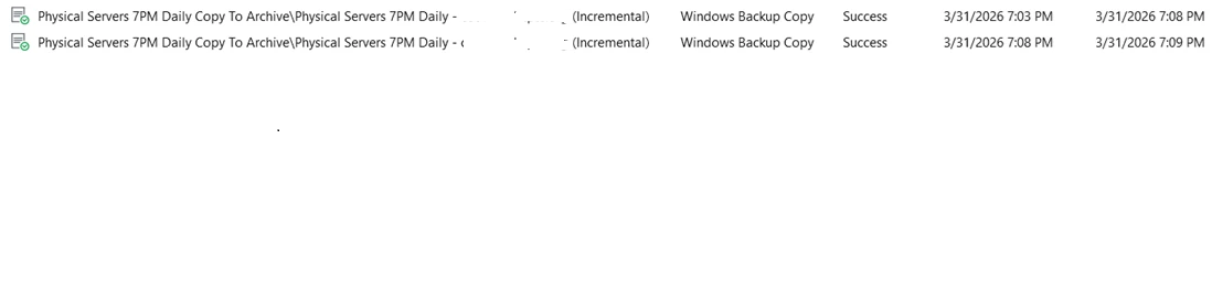

But the same job is repeating  twice , please see the screenshot in my question .
Example : Physical Servers 10PM Daily Copy to Archive at 11:05 and 11:07

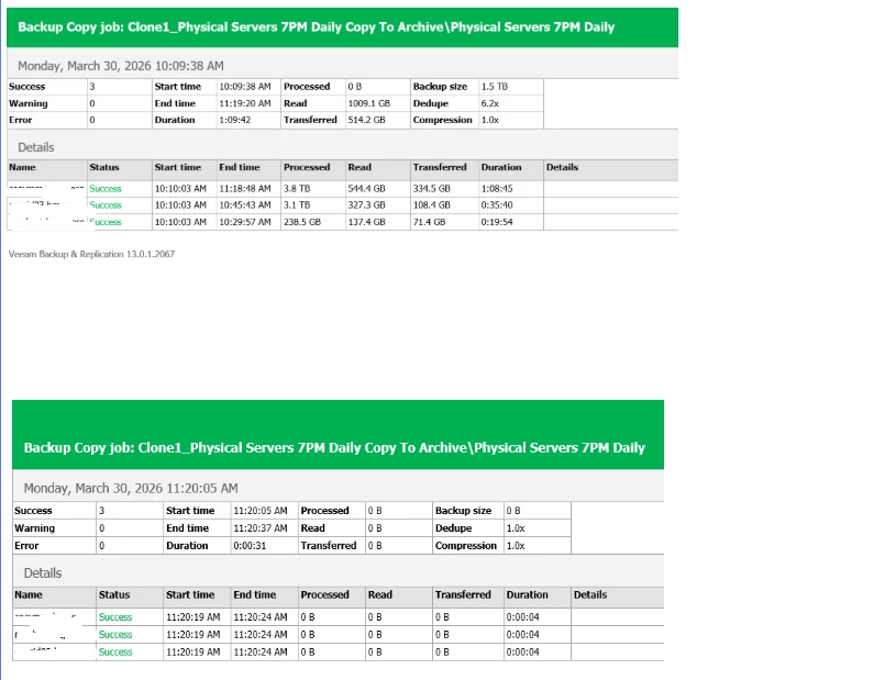

Checked , no VBEM in our environment . Is it good to test it out having a new clone copy of this BCJ or create a new BCJ for this one to see duplicate issue exists?
Marcel.K
Forum|alt.badge.img+13
  • Veeam Legend
  • Mar 27, 2026 2:56 PM UTC
Yes, thats good idea to clone copy job and with only one job inside...
  • Author
  • Influencer
  • Mar 30, 2026 4:09 PM UTC
Cloned for one job, still emailing  second copy and the processed data noted is 0B.

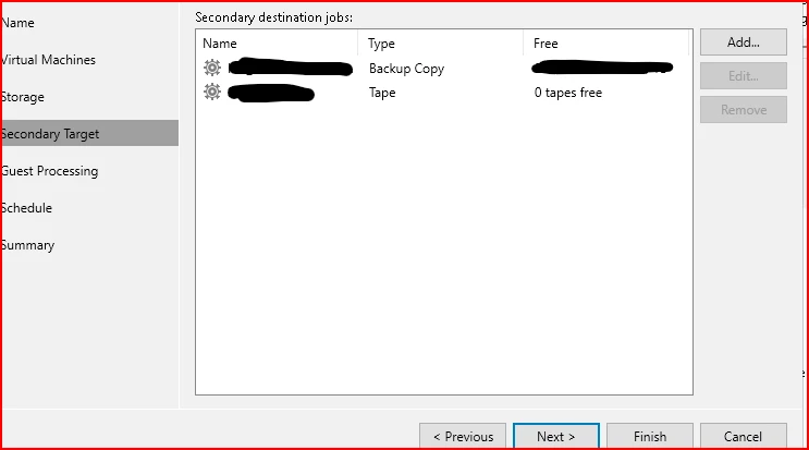

While testing, I added it to a backup job, and noticed it shows for the Backup Copy Job and Tape job as well using this script which is interesting as they do not show up like that in the GUI!
Next step is to run a job and test to see what happens.  Likely my scripting is off because it’s late and my brain is tired from today!
Scott
Forum|alt.badge.img+10
  • Veeam Legend
  • Mar 31, 2026 9:54 PM UTC
Enterprise manager, or Veeam One could also be things that are sending emails as stated above.
After testing I only received 1 email, even though that script showed the copy and tape job attached, so it might need some refinement.

I notice the time stamps are different. This may be a direction to look as well.
Take a look at your job settings. Is it possible you have 2 copy jobs attached to your primary?  For example, I could run multiple copy jobs to multiple locations, or even the same location. In this case it would be a primary job, offloaded to tape, as well as a backup copy.

Thank you all for the advice.
I disabled the Global Notification setting on the VBR server and left it turned off overnight.  This morning, I found that I only received a couple of emails from Veeam ONE.  I have enabled notifications again.
When I check the history of these jobs, here is an example of the job running twice
Marcel.K
  • Veeam Legend
  • Apr 1, 2026 11:52 AM UTC
Hi ​@Nikks
but these jobs are as two
first job is running from 7:03-7:08 and second from 7:08-7:09
so looks like first job is copying data on one storage and second jobs is moving/duplicating data to next tier/archiving
so finally you have two copies or moved from one storage to another, depends on configuration, that’s why you have two mails ...

Thanks ​@Marcel.K . Please help me where to check the configuration settings for this job.
Marcel.K
  • Veeam Legend
  • Apr 1, 2026 12:33 PM UTC
please share your copy job settings and scale out repository settings
  • Author
  • Influencer
  • Apr 1, 2026 3:31 PM UTC
We have two archive repositories (Data Domain servers).  One Data Domain server replicates the data to the other Data Domain server.  We only have one immutable storage server.  There is an extra job for both the Data Domain and immutable storage.  The second job isn’t copying anything.
