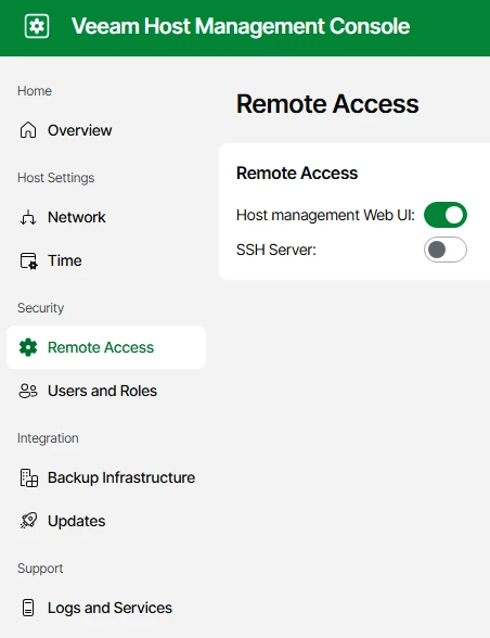

Is it possible to disabled Web UI, without disabling Host Management UI?
Our goal was to disable web ui because we’re not able to install a proper custom cert on it. So it would present an issue during our annual pen test

Hello there! The only thing that we can do is disable the host management UI:
The web UI is not allow to disable.
The VBR console used 443 port to connect on that interface.

Nope unfortunately there is not.  You can disable the MGMT UI 10443 but just that one.
