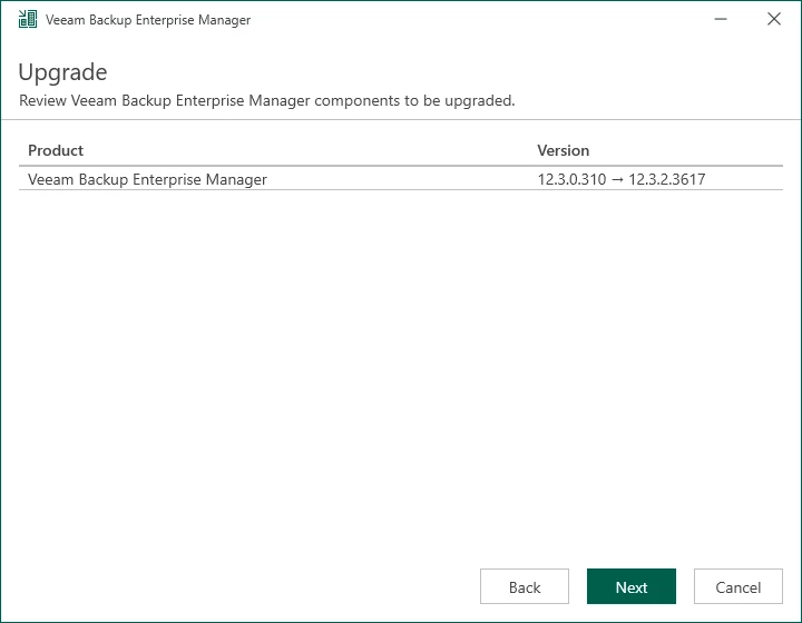

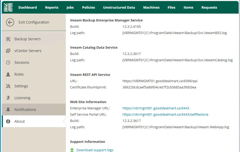

I was trying to upgrade the Veeam Enterprise Manager to v12.3.2.4165, I noticed the version is showing 12.3.2.3617 on the Upgrade page.
I view detailed information about Enterprise Manager and its components, the Veeam Backup Enterprise Manager Service build: 12.3.2.4165
Veeam Catalog Data Service build:12.3.2.3617
Web Site Information Build: 12.3.2.3617
bugs?

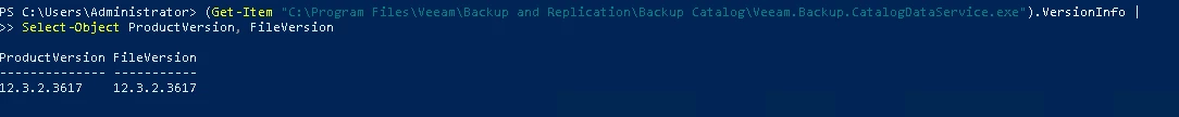

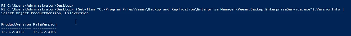

​@CarySun
There seems to be a problem with the EM update. Using the ISO and exe patch did not upgrade EM, as verified from the web console.
If I use the full ISO, it says that all components are already updated to the latest version.
Using this command results in an update; it is a cosmetic bug.
(Get-Item "C:\Program Files\Veeam\Backup and Replication\Enterprise Manager\Veeam.Backup.EnterpriseService.exe").VersionInfo |
Select-Object ProductVersion, FileVersion

Just verified myself and as noted is cosmetic but should be reported nonetheless.

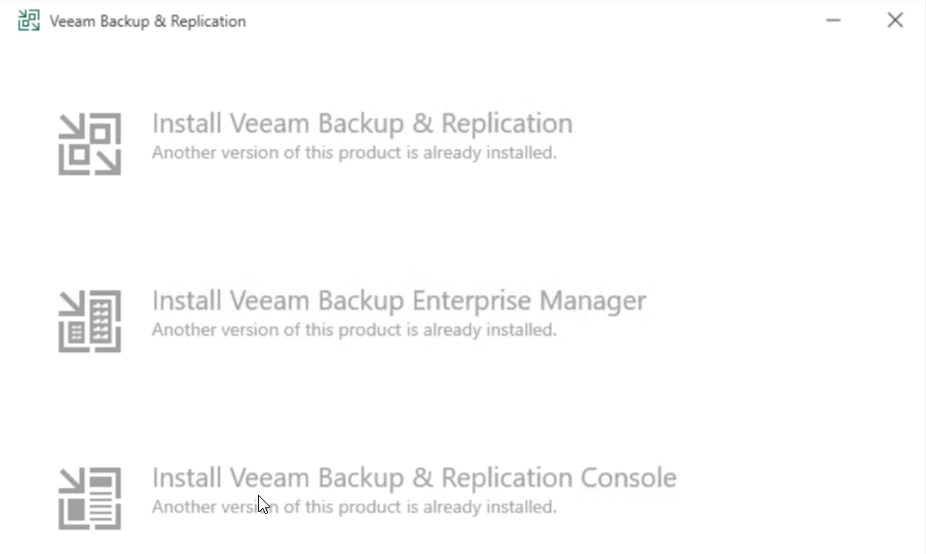

I also had issue -unable to upgrade to v12.3.2.4165 from full ISO
I’m seeing “Modify” instead of “Upgrade”  and I have confirmed that VEM Build: 12.3.2.3617
I’m using VEM and VBR on this server so I need to upgrade VEM first
for other VBRs, the patch is working good.
I run recommend command as below.
PS C:\Windows\system32> (Get-Item "C:\Program Files\Veeam\Backup and Replication\Enterprise Manager\Veeam.Backup.EnterpriseService.exe").VersionInfo | Select-Object ProductVersion, FileVersion
ProductVersion FileVersion
12.3.2.3617    12.3.2.3617
am i missing something? any advise?

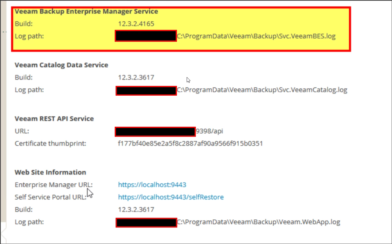

Hi,
I have the same issue.
Veeam Backup Enterprise Manager Service: 12.3.2.4165
Veeam Catalog Data Service: 12.3.2.3617
Web Site Information: 12.3.2.3617
Update of Enterprise Manager and then Veeam did not work.
The only option in the ISO was modify.
The patch zip file did work, but now there are different versions exactly like on the screenshot from waqasali.
Is this ok or should I open a case?
Thanks and regards!

This is a cosmetic bug in the UI.  Nothing to be concerned over or open a case for.  v13 fixes it.
