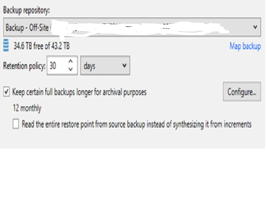

Thanks for the  answers. This is not related to this question , but if you can answer me , it will be helpful.
I know I can manually run an active full, is there a way to schedule the back copy job to do an active full rather then a synthetic full? I don't see any options in the Backup Copy job properties.

I do see this option? To read the entire restore point from the source backup instead of synthesizing it?

​@Nikks - that option will perform an Active Full for your GFS for your Backup Job..yes. What Chris shared about though was for Backup Copy Jobs.

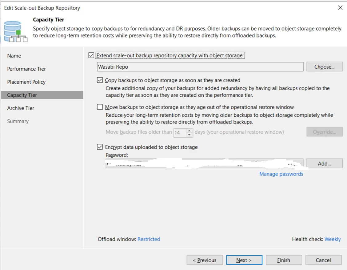

Thanks Tommy. We have our backups write to wasabi as soon as they are created:

Your current configuration gives you redundancy for the duration of the jobs retention period. If you add the “Move” checkbox, it will remove the backup files from your local repository after the set period. This is to be used as a way to reduce storage consumption in the performance tier. (Note that the setting is repository wide, and affects all backup files in the scale-out)
Yes that would do the active full you want versus the Synthetic.  As mentioned my comment was Backup Copy job options.

Our goal is to have backups stored to on-prem device for 30 days and copy to the cloud as soon as backup job are completed.
We want local retention to be 30 days, and my understanding is if the chose to  “Move Backups” the cloud will not have a copy until that date, which does not protect us for off prem.  screenshot below.
For the one-time backup, do we use days or restore points for retention policy to achieve a one-time backup?
 That is an incorrect assumption. If you choose both, they will still be copied to the capacity tier immediately.
For the one-time backup, don’t use a job. Use a Veeam-Zip.
