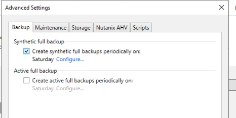

The default is forever forward incremental and then you select to run a full as shown in the screenshot on a schedule.
Okay, does synthetic means forever forward incremental. So I can assume that Synthetic as Incremental and Active Full Backup as Full Backup
Chris.Childerhose
Forum|alt.badge.img+21
  • Veeam Legend, Veeam Vanguard
  • August 6, 2025
Yes synthetic creates a full backup but an active full starts a new chain again.

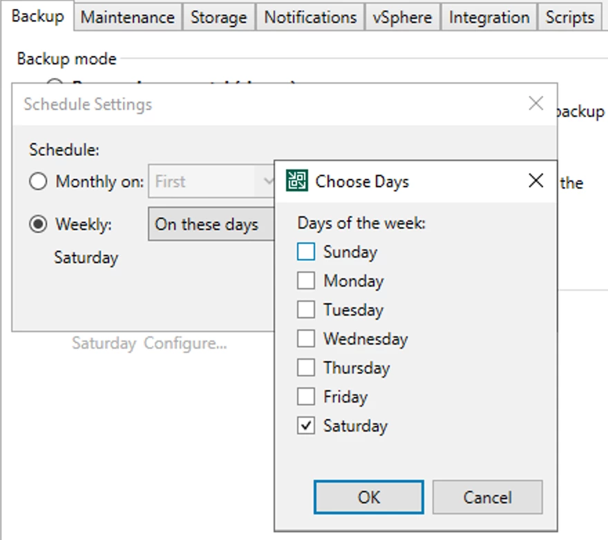

What is the difference between, selecting the day here and in schedule, are they mean the same? I am really confused to take incremental data 🙄

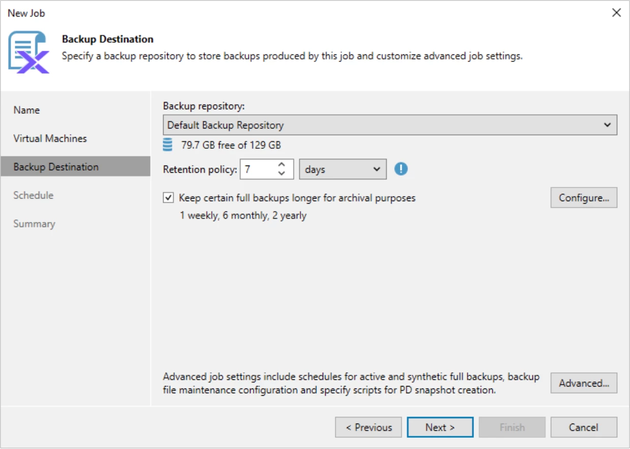

You would create your NTX Backup Job in Veeam following the NTX-Veeam User Guide, setting your Retention (screenshot below) to 14 (not 7 as shown):
NTX Backup Job Retention
Ref: https://helpcenter.veeam.com/docs/vbahv/userguide/backup_job_vbr_destination.html?ver=7

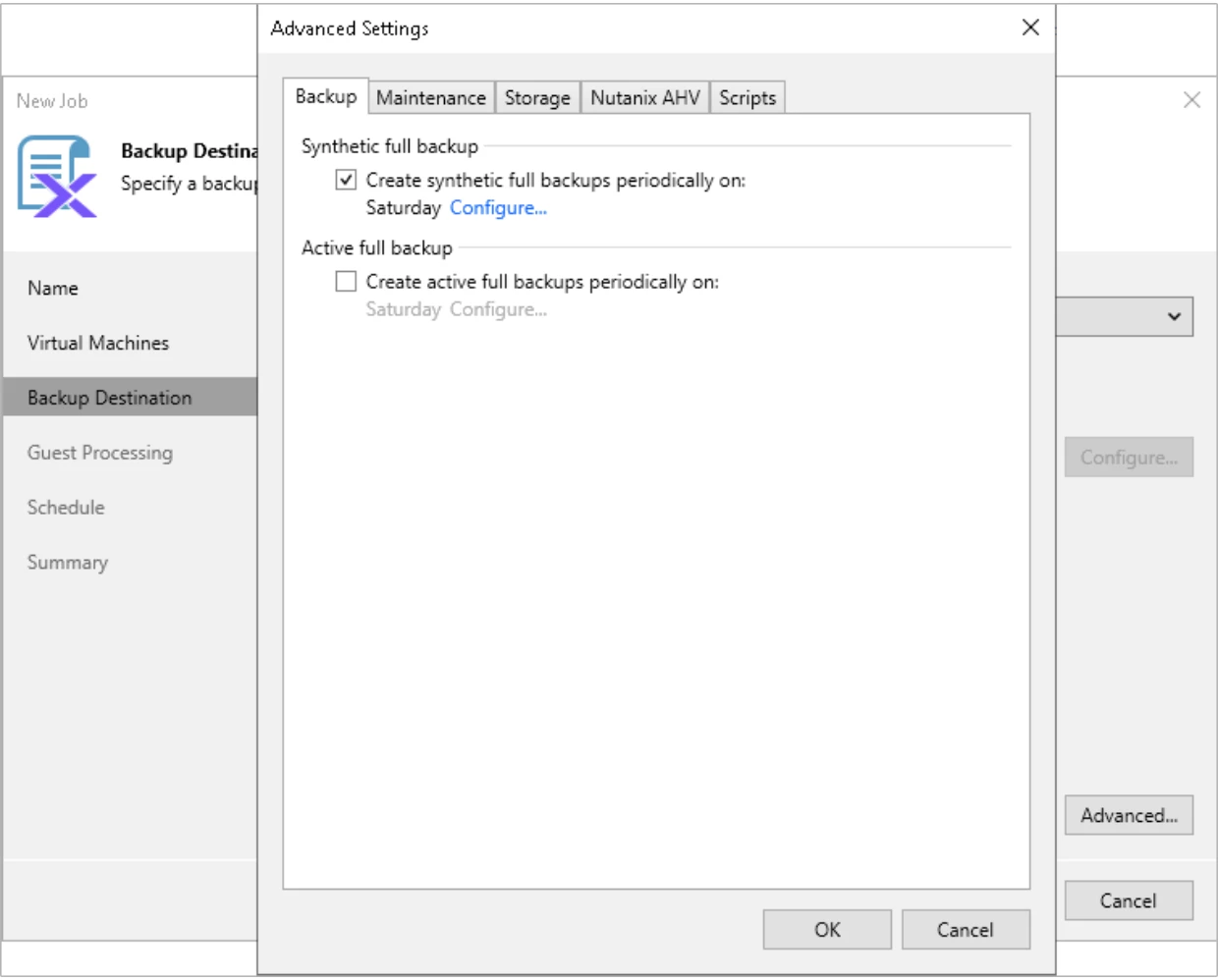

Though you can certainly configure GFS to keep 2 weekly Fulls as Chris suggests, I’m not sure you need to since your Job Retention is set to 2wks. You can probably just configure your Fulls (Synthetic or Active...whichever you prefer) to run each Fri, and since your Job will run at 10a, your Fulls would get created every wk at 10a as well. You can’t set a time when to run Fulls separately in GFS, although they would get created around the same time (10a) as the Job is scheduled for the given wk.
NTX Backup Job Weekly
Ref URL: https://helpcenter.veeam.com/docs/vbahv/userguide/backup_job_vbr_advanced.html?ver=7
What I would do is create a simple Job with 1 VM, configured as follows:
  • At the Backup Destination screen, configure Retention to 14. The first Job run will be an Active Full & subsequent Job runs will be Incremental automatically.
  • At the Backup Destination screen, click the Advanced button and on the General tab configure your Full (select Synthetic or Active) and choose Friday. It will get created each Fri at 10a. Subsequent Job runs will create Incrementals automatically.
  • Still in the Advanced section, on the Storage Tab, select Inline Deduplication. There is no “schedule” for this though

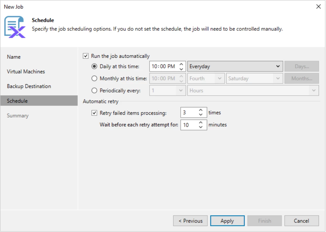

  • At the Schedule window, schedule your Job to run at 10am daily
NTX Job Schedule
I think that would take care of your requirements. Again, test this out creating a ‘test Job’ with 1 VM. Configure as shown and see if it has Retention like you want. Let us know.
