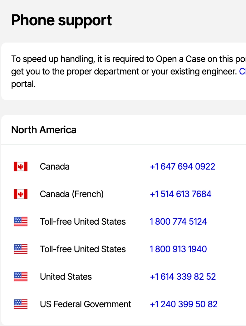

Below are numbers you can attempt for phone support to try and address your email issue:
Veeam Phone Support
