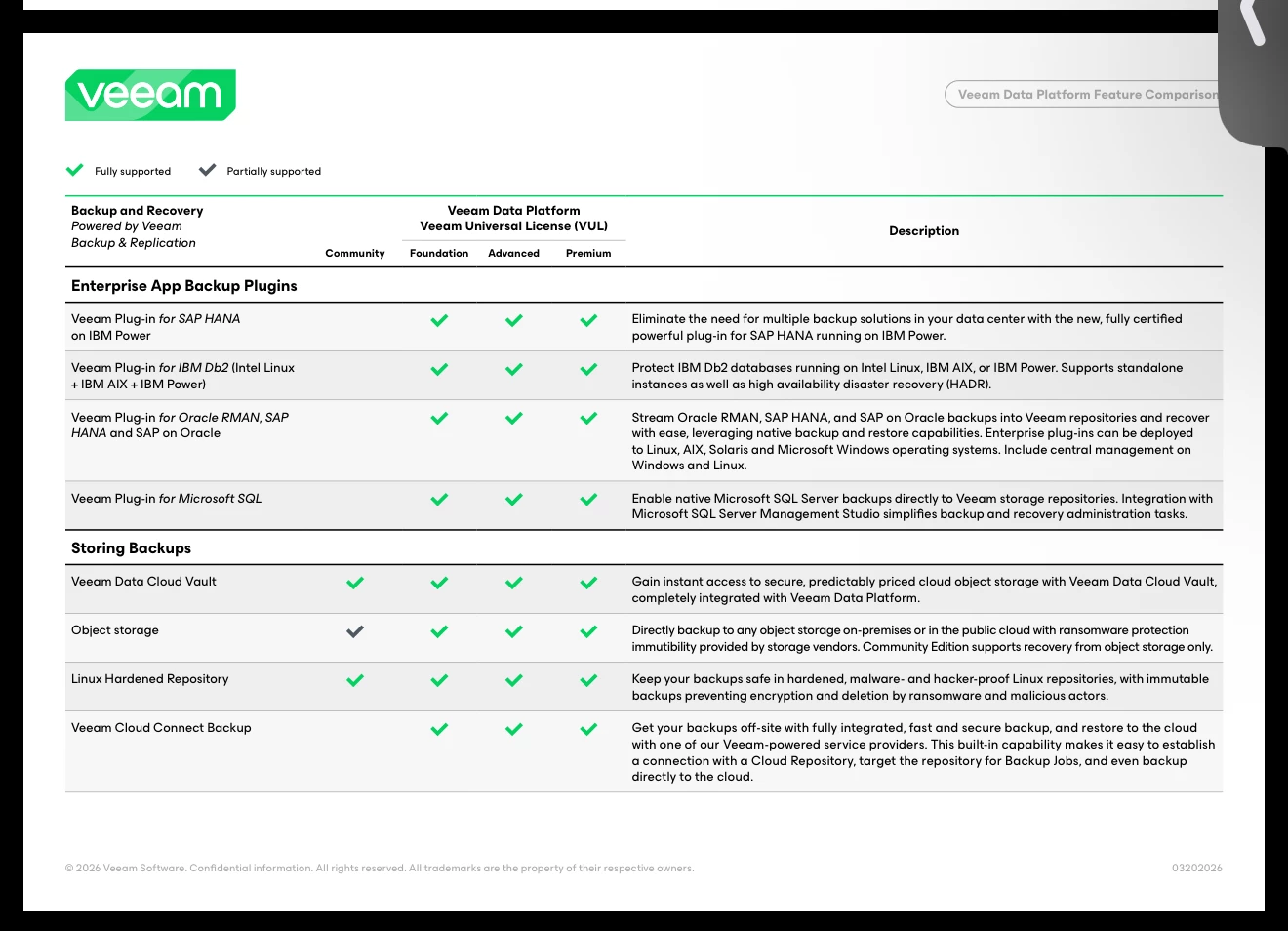

@Thomas Lahl - I just checked, and you cannot use Veeam Data Cloud Vault with Community Edition as it requires a licensed edition of VBR, which is why it worked for the other server you tried with the license.
That‘s news to me. Can you please share where we say it requires a license? It should be corrected, since the information would be wrong. Thank you. :)
VDC Vault is fully supported for our Community Edition.
https://www.veeam.com/veeam_data_platform_feature_comparison_ds.pdf
@Thomas Lahl
Please open a support case for your Vault license contract ID. Can you please share with me the case number? Here or within a private DM. Thank you.

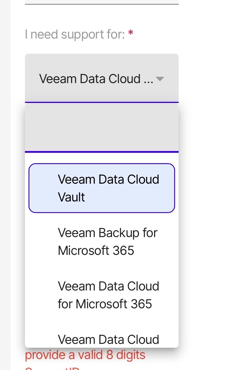

As shared in our DM, please select Vault as your product.
Since you have issues with connecting to our Vault Service, our support should process this case within the paid license case queue.
