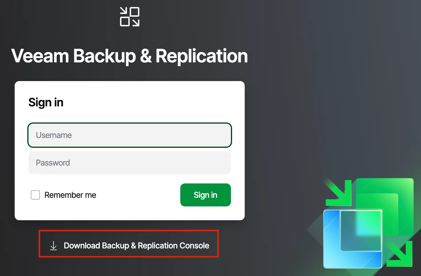

  • If you haven’t done so already, from the Web UI login screen (URL given above), download the Remote Console client (VBR Console) and install on a Windows jumpbox
    Remote Console Download​​

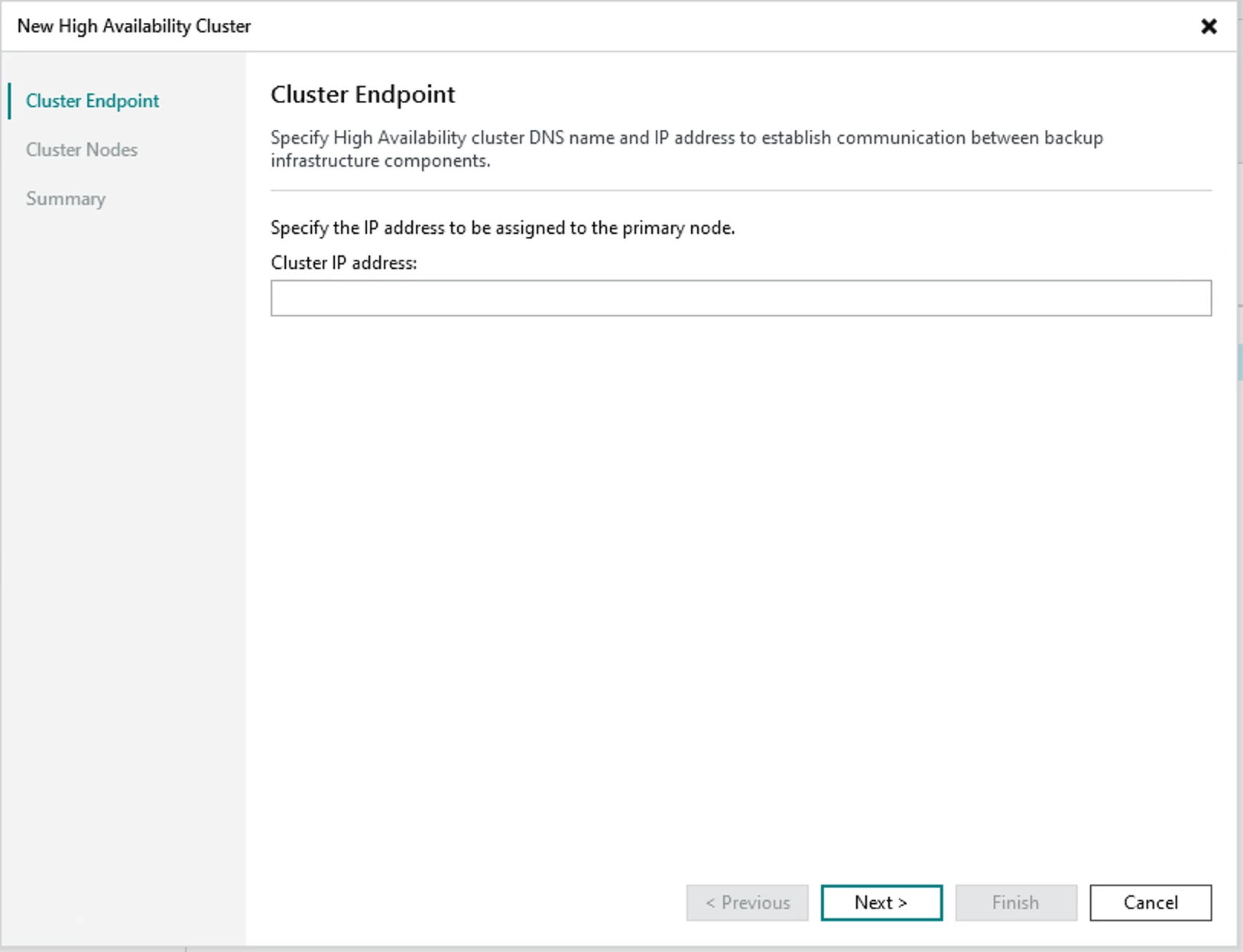

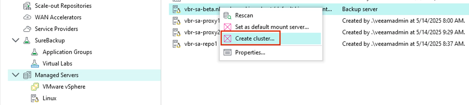

  • Log into the primary VBR server with the Remote Console > select the Backup Infrastructure node, and under Managed Servers , rt-click your VBR Server and choose the Create Cluster option
    Enable HA in Remote Console
    Then, follow the wizard:
    Create Cluster Wizard - Add HA Cluster IP

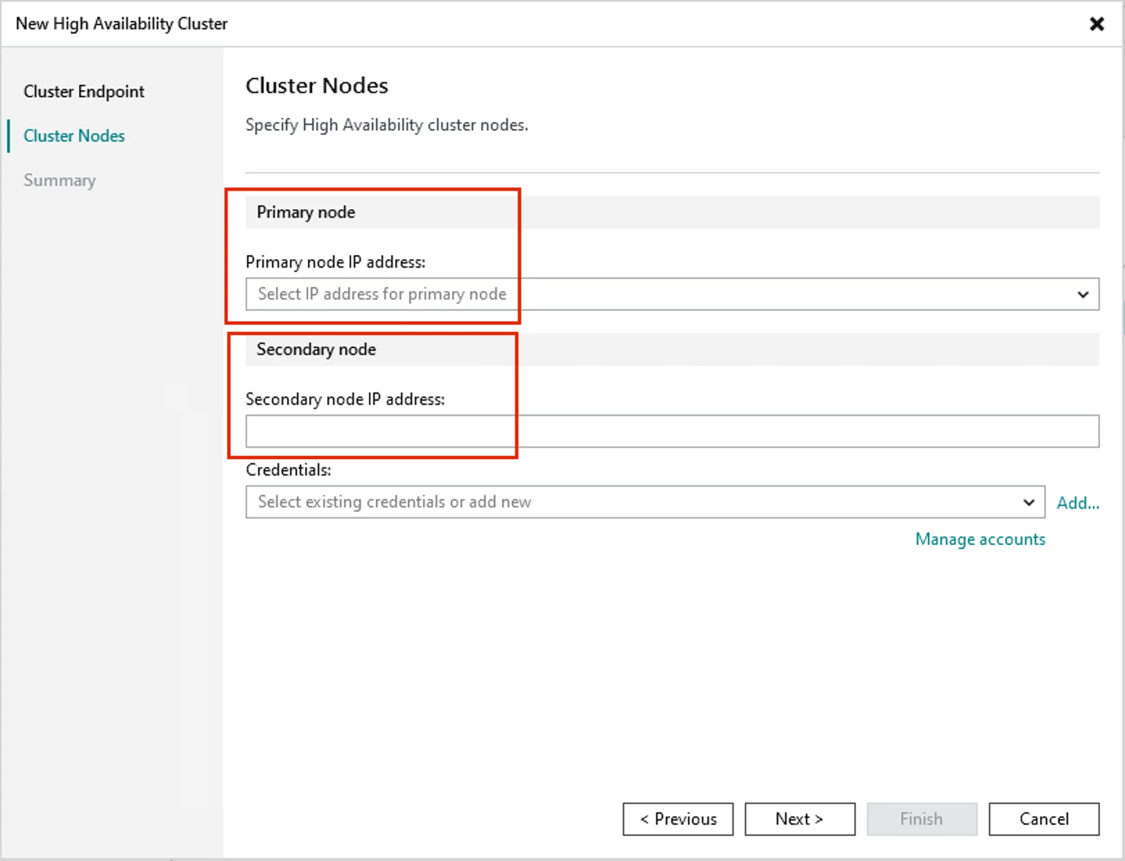

    Create Cluster Wizard - Add Both VBR Nodes

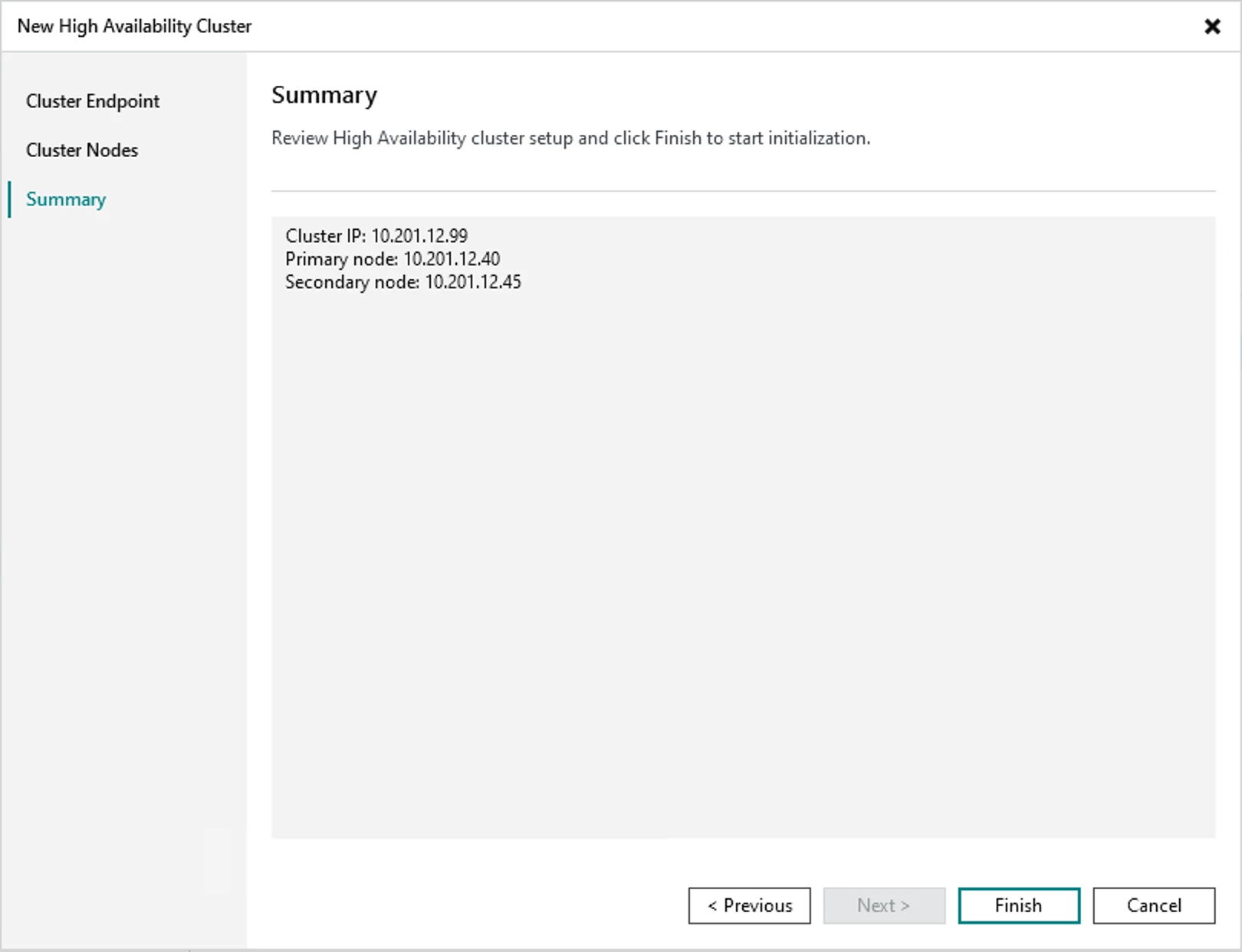

    Create Cluster Wizard Summary

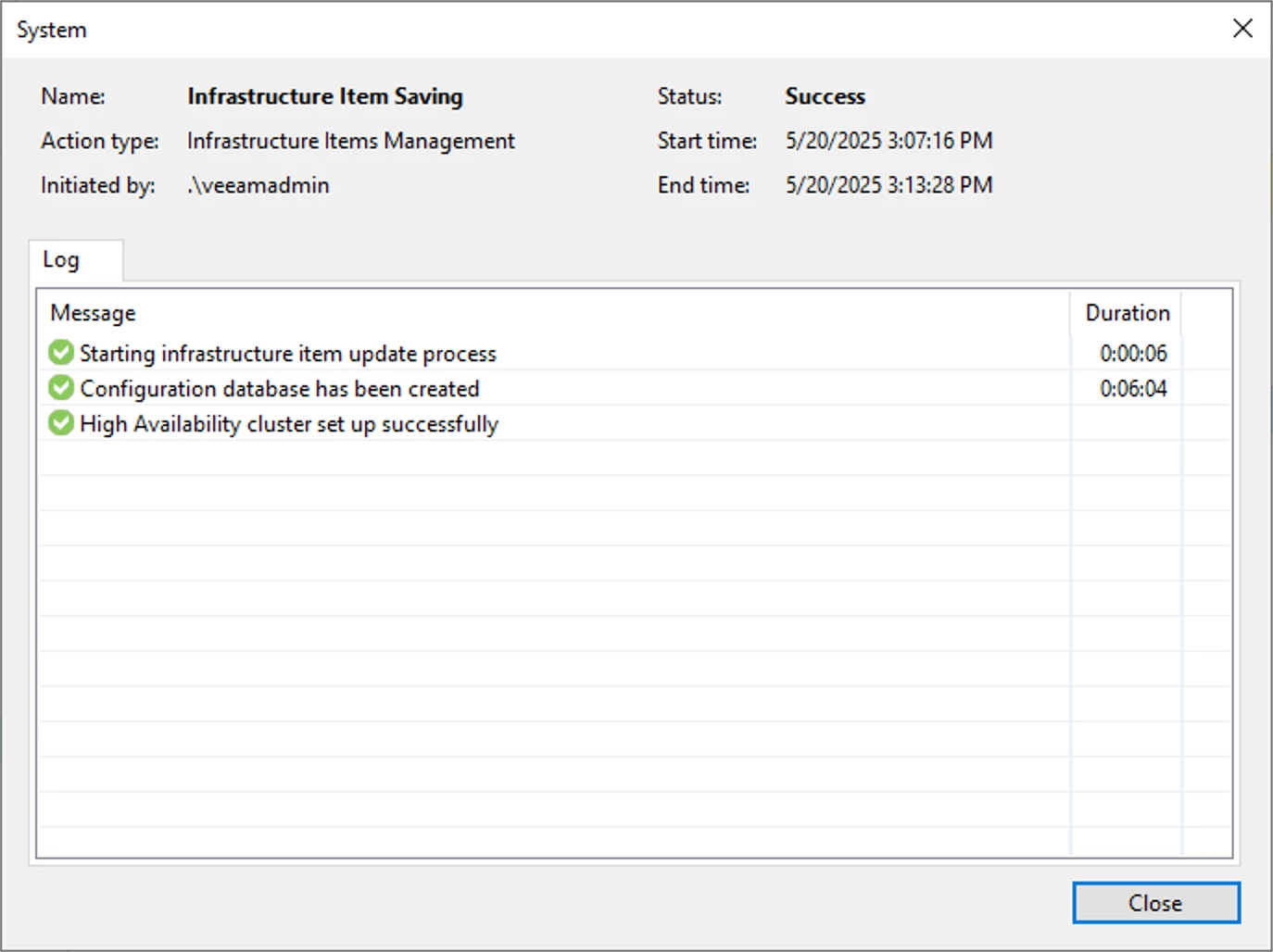

    Create Cluster Wizard - Success
  • Wait about 10-15 minutes for Veeam to sync and create the Cluster data, then log out of the Remote Console, and then re-login with the HA Cluster IP
