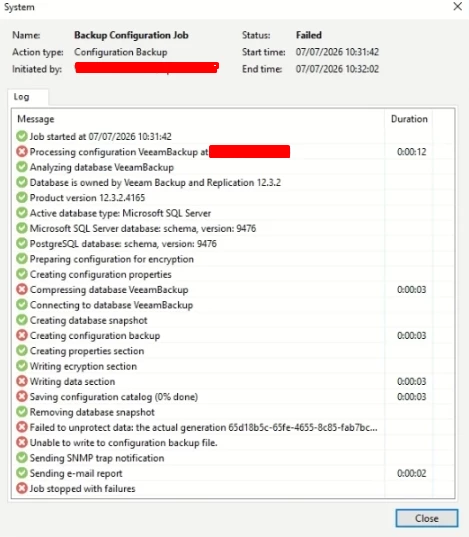

The Configuration Backup error
Whenever the Configuration Backup was executed, the session failed while writing the data section.
The log displayed the following messages:
Connecting to database VeeamBackup
Creating database snapshot
Creating properties section
Writing encryption section
Error Writing data section
Error Saving configuration catalog (0% done)
Error Configuration database is corrupted.
Error Unable to write to configuration backup file.
Job stopped with failures
The main error was:
The connection to the database and the creation of the database snapshot completed successfully.
The failure occurred when Veeam attempted to write the configuration data to the backup file.

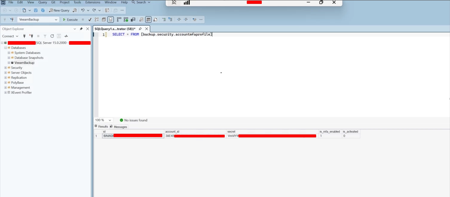

Step 4: Identify the record related to the issue
Open SQL Server Management Studio and connect to the SQL Server instance hosting the Veeam configuration database.
Select the Veeam configuration database and run:
SELECT * FROM [backup.security.accountmfaprofile];
Identify the record associated with the issue and copy the value from the id column.
Be careful when collecting screenshots from this table.
Before publishing any image, hide sensitive information such as:
  • Secrets
  • Account identifiers
  • Usernames
  • Server names
  • IP addresses
  • Any other environment-specific information
This record should only be removed after the correct ID has been identified and the procedure has been validated with Veeam Support.

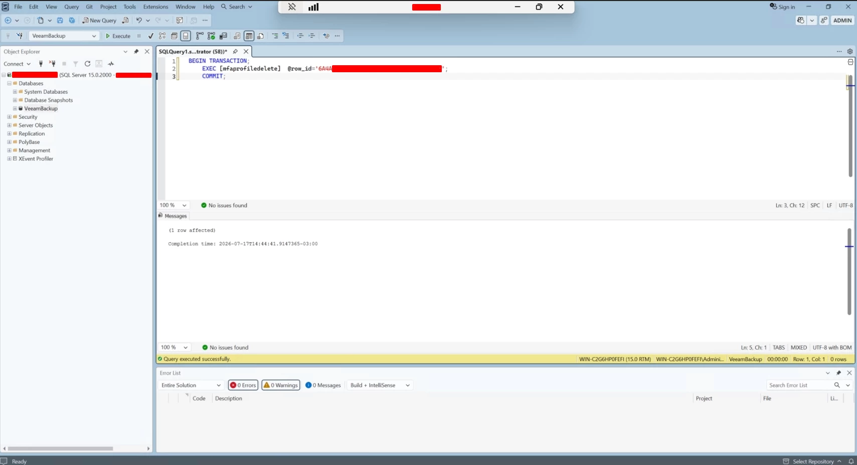

Step 5: Apply the database correction
After creating the database backup, confirming that no Veeam activities were running, stopping the services, and identifying the correct record, the following command was executed:
BEGIN TRANSACTION;
EXEC [mfaprofiledelete]
@row_id = 'PASTE-THE-ID-HERE';
COMMIT;
Replace:
PASTE-THE-ID-HERE
with the value copied from the id column in the previous step.
This command must only be executed against the specific record identified during the investigation.
Do not remove additional records or use this procedure as a general solution for other Veeam Configuration Backup errors.
Any direct modification to the Veeam configuration database should be reviewed with Veeam Support before being applied in a production environment.

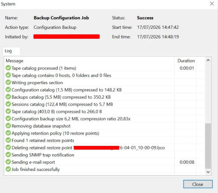

Step 8: Run the Configuration Backup again
After confirming that Users and Roles was accessible, I manually started the Veeam Configuration Backup again.
This time, the session completed successfully.
The configuration data and catalog information were written to the backup file, and a new valid Configuration Backup restore point was created.
The result
