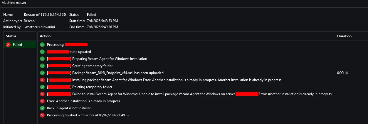

First issue: another installation already in progress
The first error we saw from the VBR console was:
01/06/2026 22:34:43 Failed : [172.16.254.120] Installing package Veeam Agent for Windows Error: Another installation is already in progress. Another installation is already in progress.
01/06/2026 22:34:43 Succeeded : [172.16.254.120] Deleting temporary folder
01/06/2026 22:34:43 Failed : [172.16.254.120] Failed to install Veeam Agent for Windows: Unable to install package Veeam Agent for Windows on server 172.16.254.120 Error: Another installation is already in progress.
Since the server had many active RDS users, stopping or killing Windows Installer sessions was not something we could do casually. We had to wait for the approved maintenance window, check for active msiexec.exe processes, kill the stuck ones, and then retry the deployment.

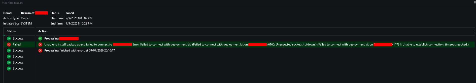

After clearing the stuck Windows Installer processes, we retried the deployment from the VBR console. This time, the MSI package was uploaded, but the installation ran for more than one hour and failed with a timeout.
6/29/2026 9:03:46 AM Succeeded : [172.16.254.120] Package Veeam_B&R_Endpoint_x64.msi has been uploaded (0:00:13)
6/29/2026 10:18:47 AM Failed : [172.16.254.120] Installing package Veeam Agent for Windows Error: Reconnectable socket: failed to receive data synchronously, timeout
Reconnectable socket: failed to receive data synchronously, timeout (1:15:00)After that, Veeam also failed to delete the temporary MSI folder because the file was still locked by msiexec.exe:

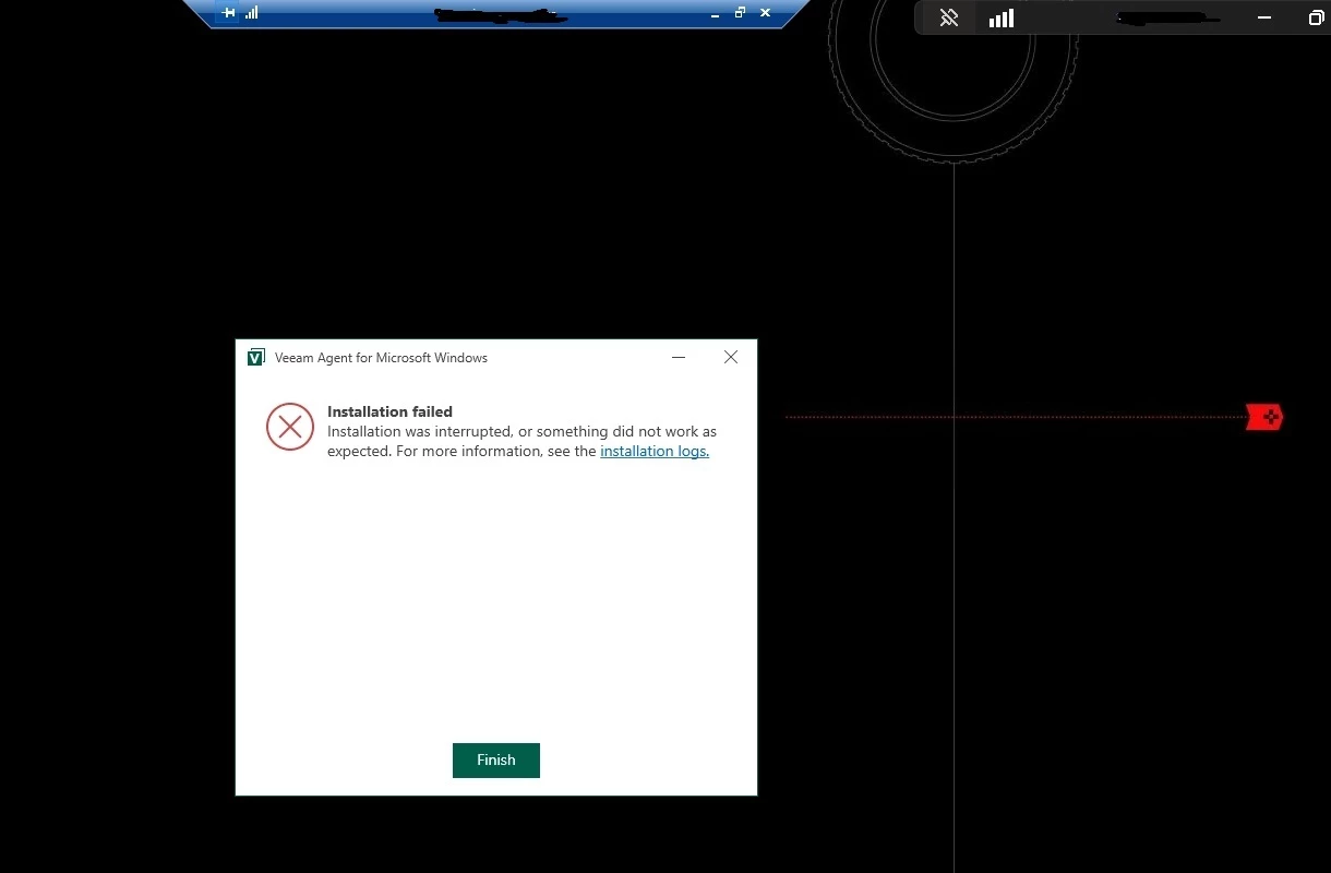

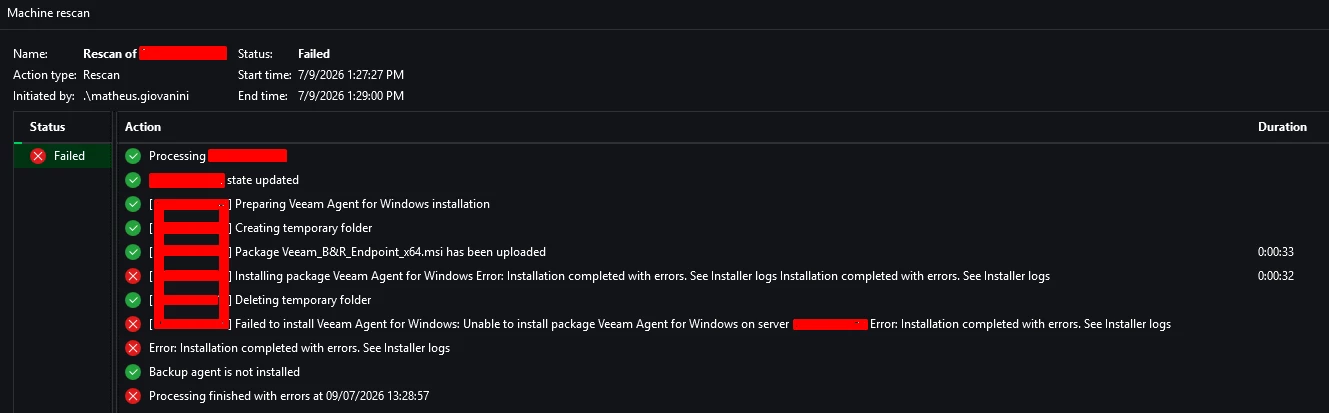

Since the VBR console error was too generic, I decided to try a manual deployment to get a better installation log.
On the target server, I noticed that some Veeam components were installed, such as:
Veeam Installer Service
Veeam Backup Transport / Deployment componentsBut the VAW itself was not installed.
So I exported the installation files from the Protection Group. This package includes the required MSI/EXE files, XML files, certificates, and scripts used to register the Agent back to VBR.

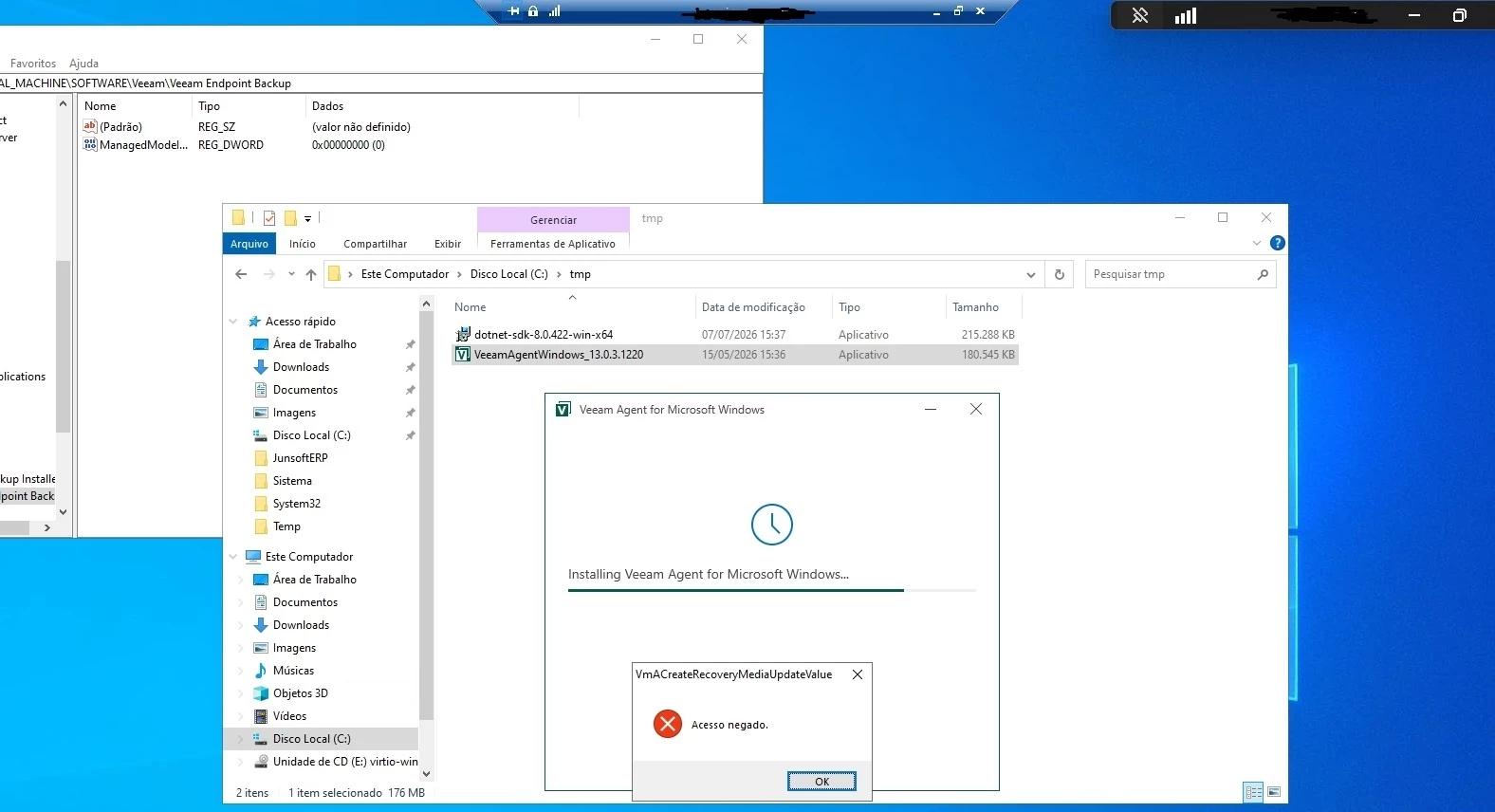

Then I ran the MSI manually with verbose logging:

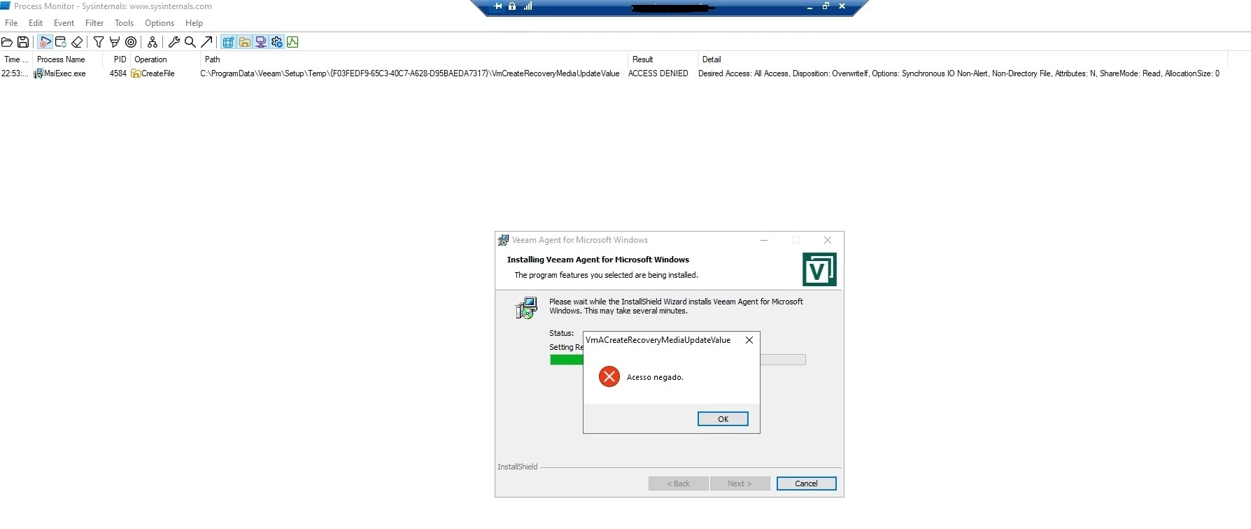

msiexec /i "Veeam_B&R_Endpoint_x64.msi" /l*v C:\Temp\VAW_install_manual.logThat is when I finally got a more identifiable error:
VmACreateRecoveryMediaUpdateValue
Access deniedThe MSI verbose log also showed:
Product: Veeam Agent for Microsoft Windows -- Installation operation failed.
Installation success or error status: 1603.
MainEngineThread is returning 1603.
Return value 3.At this point, the issue was no longer just “deployment timeout”. The installation was failing locally on the Windows server with Access Denied during a specific MSI custom action.

The first ProcMon filter I used was:
Process Name is msiexec.exe Include
Result is ACCESS DENIED IncludeLater, I also used a broader filter:
Path contains C:\ProgramData\Veeam\Setup\Temp Include
Result is ACCESS DENIED IncludeProcMon showed Access Denied on a temporary Veeam setup component:
C:\ProgramData\Veeam\Setup\Temp\{GUID}\VmCreateRecoveryMediaUpdateValueThis matched the MSI custom action that was failing:
VmACreateRecoveryMediaUpdateValueAt first, I thought this could be related to NTFS permissions, GPO, antivirus, firewall, AppLocker, Software Restriction Policy, or something similar.

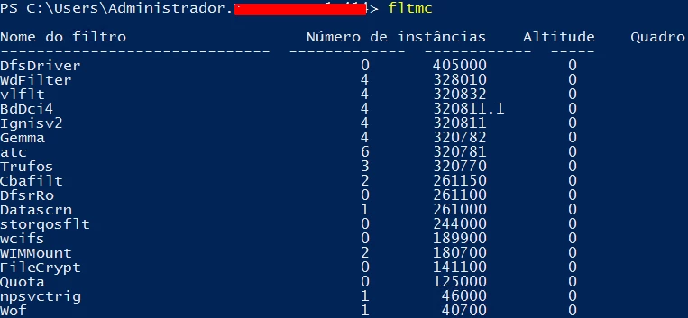

The clue: filesystem filters
The command that finally gave us the right direction was:
fltmc filtersThis command lists filesystem minifilters loaded in Windows.
In this server, we found filters such as:
Datascrn
WdFilter
CbafiltA brief explanation:
Datascrn - File Server Resource Manager / File Screening
WdFilter - Microsoft Defender filesystem filter
Cbafilt - Carbon Black filesystem filterThese are not regular applications running in the foreground. They are filesystem filters loaded into the OS. Their job is to inspect, monitor, allow, deny, or control file operations at a lower level.
When these filters are enabled, they can intercept operations such as:
- File creation
- File execution
- MSI temporary custom actions
- Access to temporary setup folders
- Security-sensitive file operationsSo even if NTFS permissions look correct, a filesystem filter can still block or interfere with an operation.

Resolution
During an approved maintenance window, with the customer’s Microsoft/security team involved, the filters were temporarily unloaded.
The commands used were:
fltmc unload Datascrnfltmc unload WdFilterfltmc unload CbafiltAfter unloading these filters, the VAW installation completed successfully.
Then the filters were loaded again:
fltmc load Datascrnfltmc load Cbafiltfltmc load WdFilterAfter the Agent was installed, the backup job started and ran normally.
The important point is: in this case, the filters only had to be temporarily unloaded for the installation. After the Veeam Agent was installed, the filters were enabled again and the backup routine continued to work normally.
