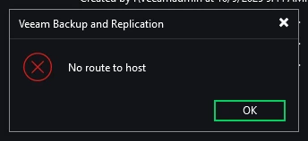

Another day and another tip that I came across in my homelab.  I had two older VHRs that I removed from my environment but when trying to delete them in the WebUI or Console it would give me an error about - No Route to Host
So I checked with our Veeam SE team and found the following workaround using PowerShell to remove the servers which ended with a warning but that was due to not being able to connect to them.
