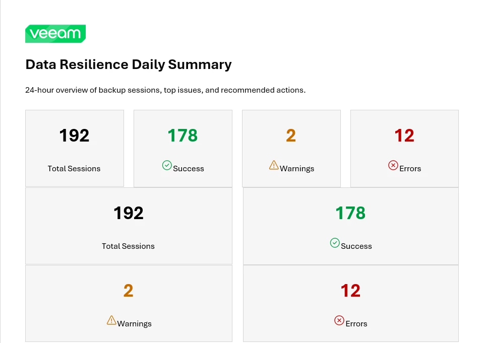

A typical overnight run in a multi-site environment might process close to 200 backup sessions. Most succeed. A few don’t.
The report starts with a clear summary, how many ran, how many succeeded, and how many had errors or warnings. You immediately know whether the day is routine or needs attention.

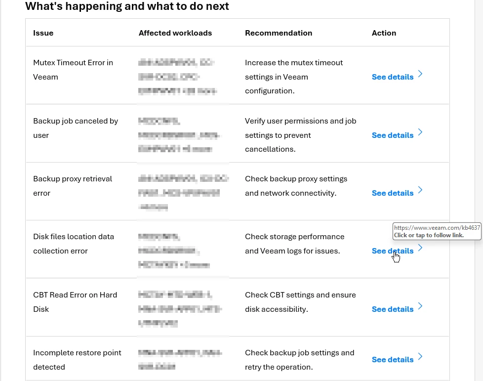

Issues are grouped logically. You might see VSS timeouts affecting a set of VMs, CBT read errors on others, or warnings about outdated VMware Tools.
Each group includes a clear recommendation. Not “check logs,” not an error code, but something actionable. Increase VSS timeout, reset CBT, check proxy connectivity.

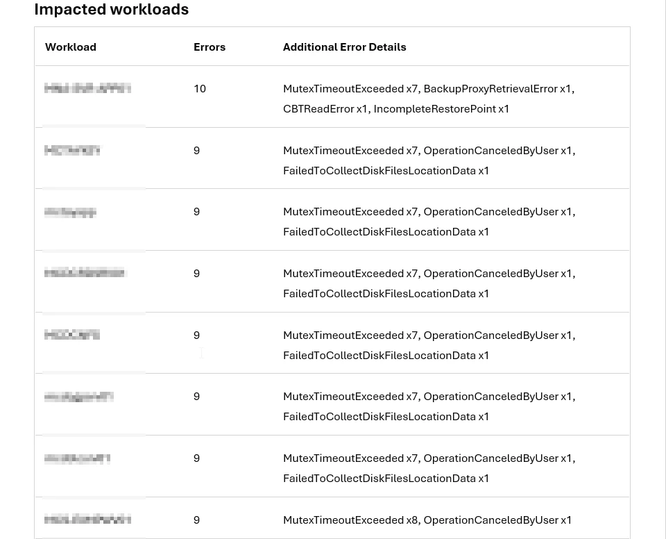

Below that, you see the workloads with the most errors. This helps you decide where to focus. A VM with repeated identical errors is very different from one with multiple different issues. The report helps you see that instantly, without digging through logs.

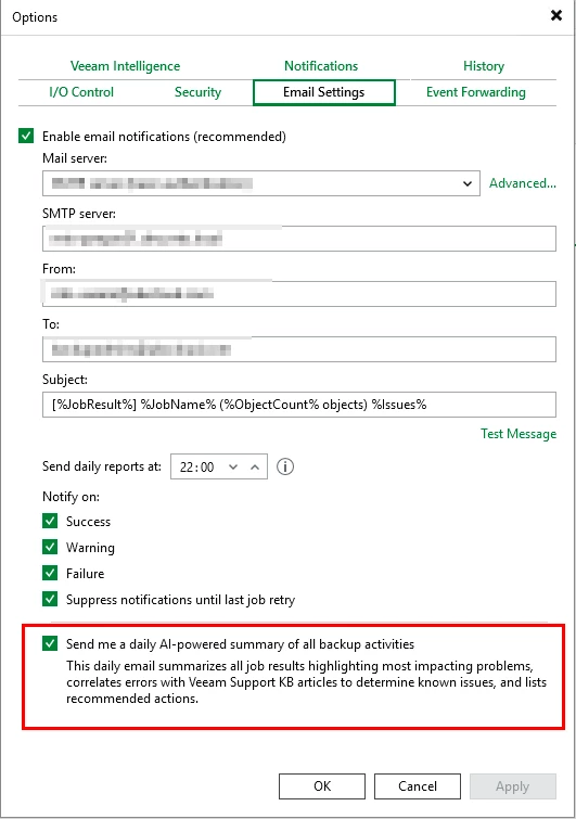

How to enable the Veeam Data Resilience Daily
  1. Login to Veeam Backup & Replication Console
  2. Open Options from the main menu, navigate to Email Settings
  3. Select "Send me a daily AI-powered summary of all backup activities”
