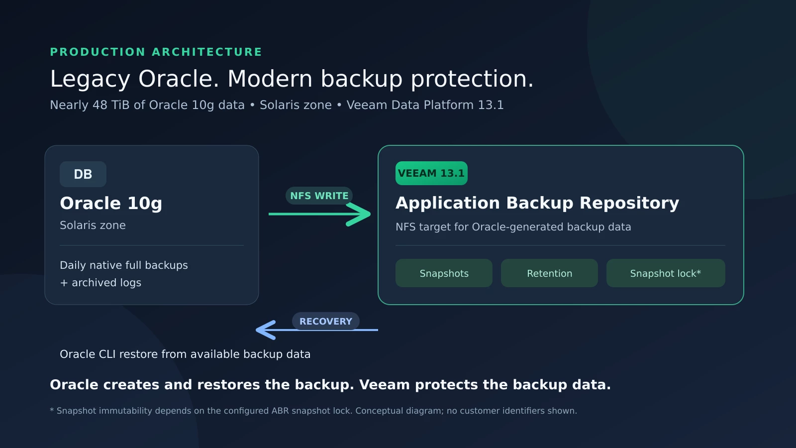

ABR let me change the design. Oracle could create its own backup and write it to an NFS target, while Veeam managed snapshots and retention for the repository. Veeam describes ABR as a capability of the Veeam Infrastructure Appliance in Hardened Repository mode, with NFS targets for application-generated data. Veeam 13.1: Application Backup Repository.
Oracle creates the backup. Oracle restores the backup. Veeam protects the backup data.
That distinction matters. Upgrading Veeam didn’t add Oracle 10g to the RMAN plug-in support list. I changed where Oracle’s native backups landed and how I protected the resulting data.

After the upgrade, I configured the Application Backup Repository, made its NFS storage available to the Solaris environment, and directed the Oracle backup process to that location. I configured daily full backups and archived log backups.
At this size, repository capacity, retention, backup windows, and recovery time all mattered. I wasn’t looking for a place to park files. I needed a backup process I could manage and, above all, use when something went wrong.
So I tested recovery from the Oracle CLI. The native backups completed, and I successfully restored using Oracle’s tools. That gave me confidence in the part that matters most: Oracle could use the backup data I had written to the repository.
Veeam also documents an ABR instant export option that exposes a selected snapshot through a temporary, read-only NFS path. That provides a way to access an older repository point without changing the live share. It’s a useful recovery option to understand, though I’m not claiming I used that specific export workflow in my test. Veeam’s ABR recovery options.
