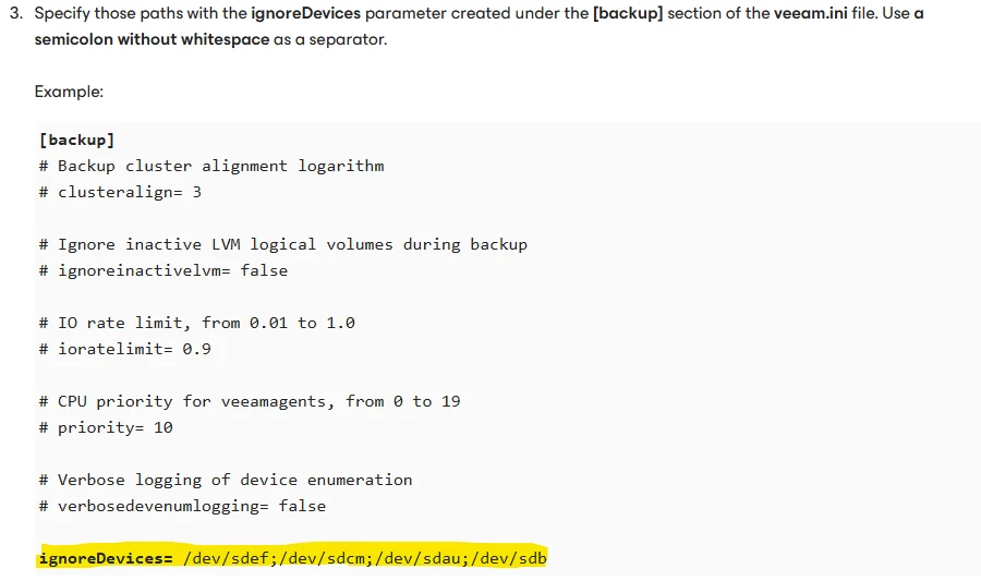

The customers systems hosted Databases (MAXDB) which we backed up in a seperate job with a pre script. This Script dumped the DB and Logs and after that we backed up the Volume.
Which means we wanted to create a second job which backed up only the remaining volumes, so we chose “Volume Level Backup”.
The Issue was that there is a limitation in the documentation:
https://helpcenter.veeam.com/docs/agentforlinux/userguide/system_requirements_nosnap.html?ver=60
  • The amount of space required for LVM snapshots largely depends on the IO intensity. Generally, from 10% to 20% of the system’s occupied space should be enough for storing an LVM snapshot.
But the Customer had a lot of volumes which did not have enough space and wasnt able to enlarge them.
When we chose “Entire Computer” we did not run into the problem, but that meant that we back up Data twice since we backed up the DB already seperately.
The Solution was in this KB the 3rd Bullet Point:
https://www.veeam.com/kb2771
We added the DB volumes to the ignoreDevices, restarted the veeamservice as described, after that the Entire Computer Backup job ran without Issue and ignored the Volumes.
