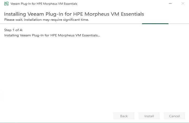

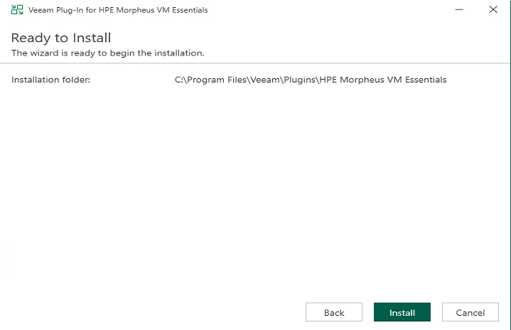

3. Run the Installer

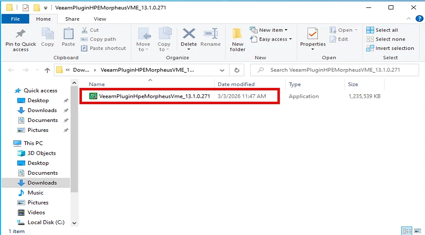

Launch the VeeamPluginHpeMorpheusVme_13.1.0.271.exe file on the backup server. The setup wizard will guide you through:
Click NEXT to start the Install process

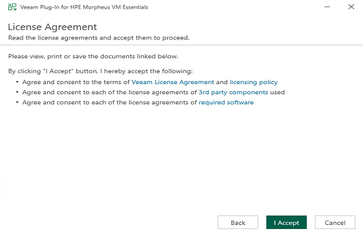

Accept the license terms and conditions

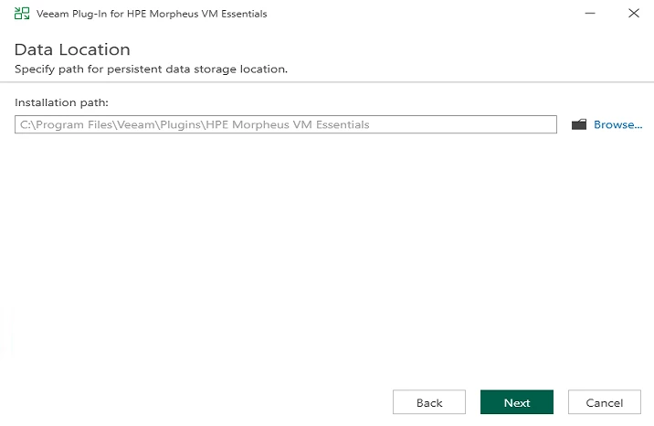

Choose the location to install the plug-in
Click INSTALL
The installation is in progress

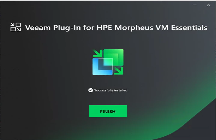

Click FINISH
The installation is lightweight and typically completes in a few minutes

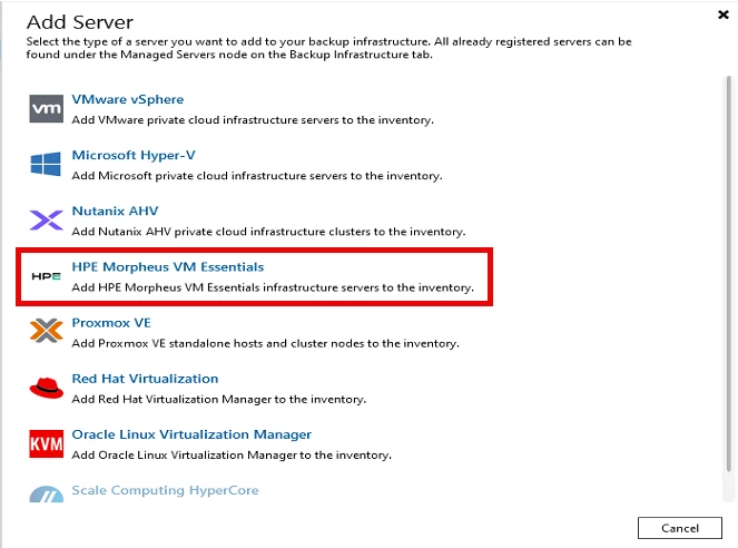

Open the Veeam Backup & Replication console
Navigate to Inventory ==> Virtual Infrastructure ==> Right-click to add Server
Select HPE Morpheus VM Essentials

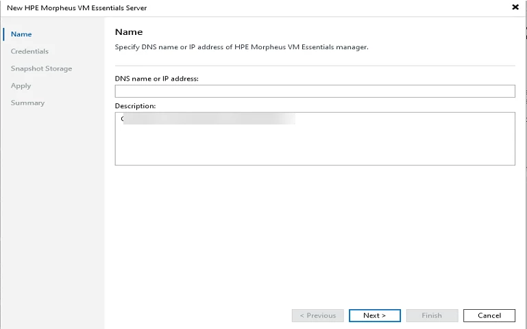

Add the IP address or FQDN of the HPE VM Essentials Server ==> Click on NEXT

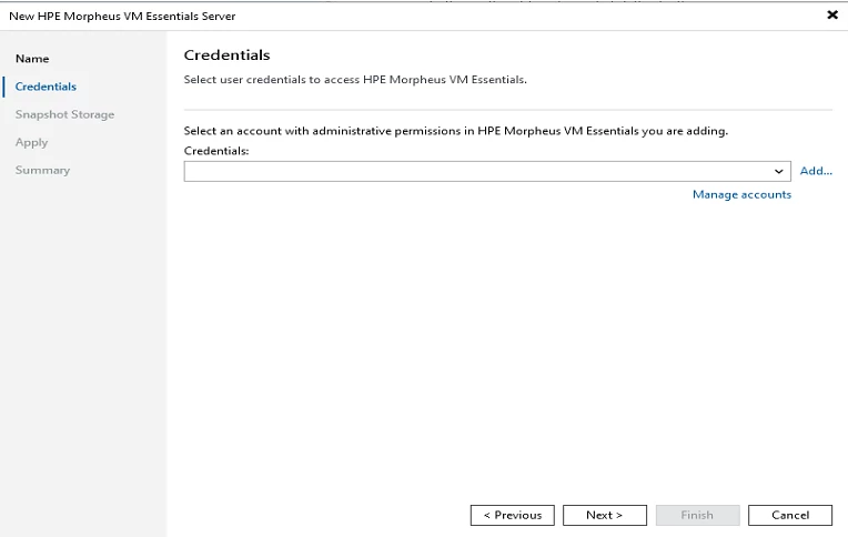

Add the credentials to connect to the HPE VM Essentials server ==> Click NEXT

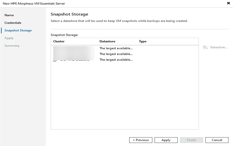

Select a Datastore to keep the VM snapshots ==> Click APPLY
The server will register with Veeam==> Click FINISH when prompted

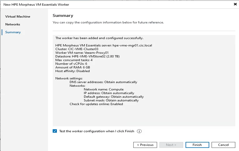

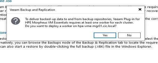

Deploy the Worker
The worker is a lightweight proxy virtual machine running on hosts in a cluster. They handle data-plane operations, including transport, inline deduplication, and compression during backup and restore operations.

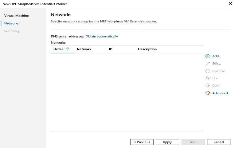

Enter the FQDN or IP address for the Worker
Select the Network for the Worker ==> Click Next when finished

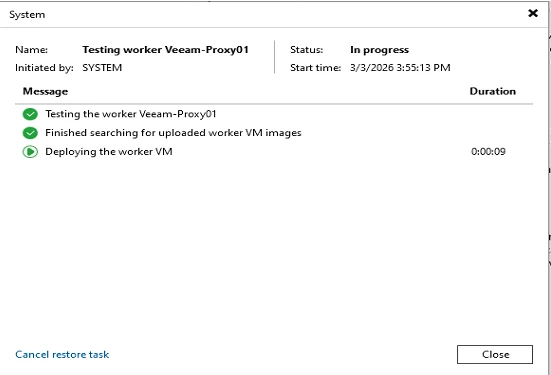

Once completed ==> Click the checkbox to test the worker configuration ==> Click FINISH
The Worker will go through the test process ==> click CLOSE

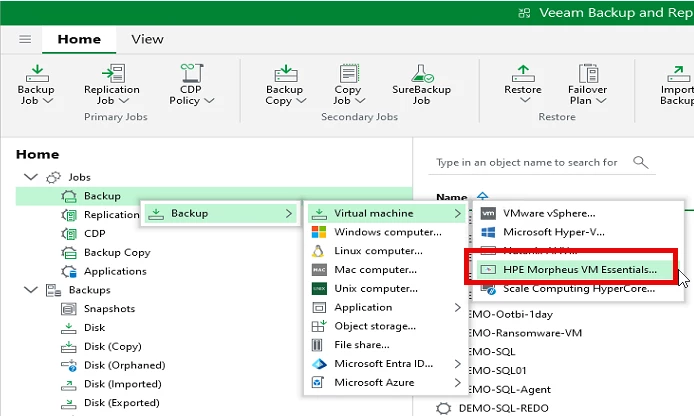

Now, you can create the backups jobs for VM Essentials workloads
Right-click Backup ==> Virtual Machine ==> HPE Morpheus VM Essentials
Create the Backup Job and Schedule

Great post, thank you for documenting. Question, the datastore for hosting the VM snapshots, is that a VM Essentials datastore and is it just for storing snapshots while Veeam processes them, or are they held more longer-term?
kciolek
Forum|alt.badge.img+6
  • Author
  • Influencer
  • Mar 5, 2026 2:27 PM UTC
Of course! Yes, that is a VM Essentials datastore, you get to select during the install process. The snapshots are temporary and only last during the Veeam backup and should be deleted after the backup finishes.
Hi, thanks for the article…
Just tried it myself on my Windows based Veeam 13.0.1.1071 instance…
Installed the plugin successfully, restarted the Veeam service (even rebooted the server) but when I go to Infrastructure - Add Server I only see VMware and Hyper-V, don’t see VME… Any idea what the issue can be?

Hmm ..interesting. You only see Hyper-V and VMware? No Proxmox, RedHat, or Oracle. They should be there by defult. What tpe of licensing do you have?

Same situation for me… i hame E+ model and go from Veeam11 to 13 via upgrade on my HW Server. There is some progress in this situation?

What licensing do you have? Can you check to see if the services are started for the plug-in? Alos, try a reboot, if none of this works I would open a case with support.

Enterprise Plus VULs on WIN2022 Backup and Replication SRV / every VEEAM services are in running state. Only issue after update from 12 to 13 was blocked VEEAM NFS Service, because native Windows service “Port Map” use same NFS port. Reboot not working too.

I would open a case with support if you didn’t already. Please let us know what they come back with.
