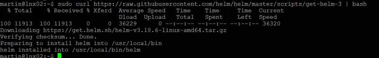

Helm installation
It is required to install Helm, as it is the package manager for Kubernetes:
sudo curl https://raw.githubusercontent.com/helm/helm/master/scripts/get-helm-3 | bash

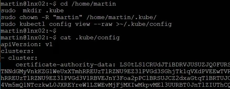

Now we need to create the .kube configuration file for the user. In this case, the user is: martin.
cd /home/martin
sudo  mkdir .kube
sudo chown -R "martin" /home/martin/.kube/
sudo kubectl config view --raw >~/.kube/config

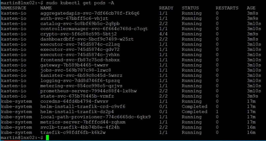

Validates the status of the pods:

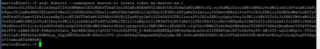

Once the service user has been created, generate an access token:
sudo kubectl --namespace kasten-io create token my-kasten-sa-1

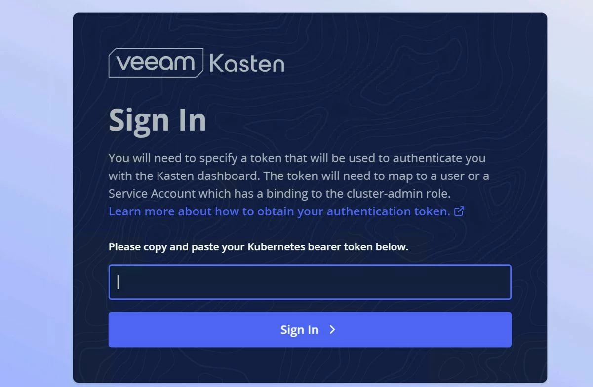

With the token created, copy and paste it into the login prompt that appears when accessing Kasten:
