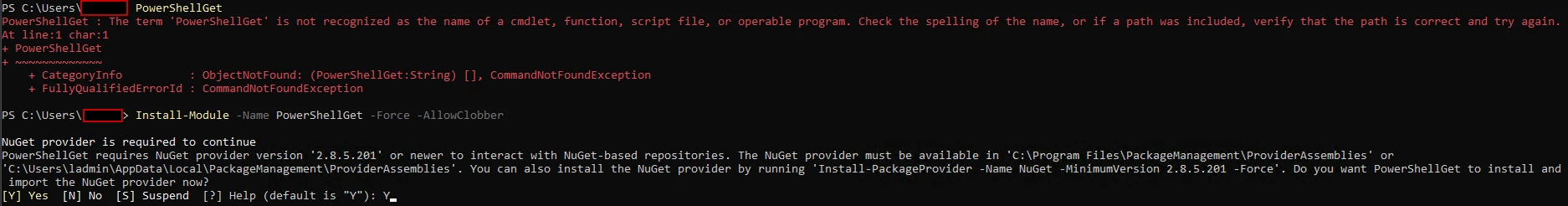

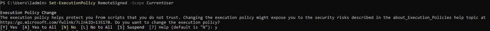

  • Ensure PowerShellGet is updated (recommended)
Install-Module -Name PowerShellGet -Force -AllowClobber
Set-ExecutionPolicy RemoteSigned -Scope CurrentUser

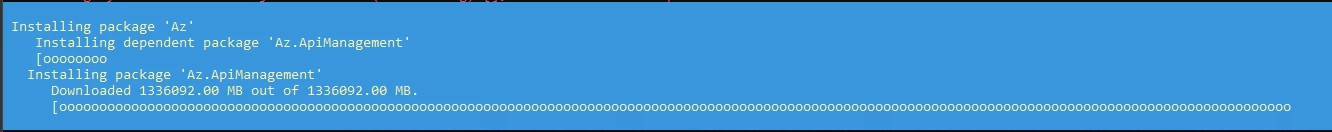

  • Install the Az module
Install-Module -Name Az -Scope AllUsers -Repository PSGallery -Force
Update-Module -Name Az -Force

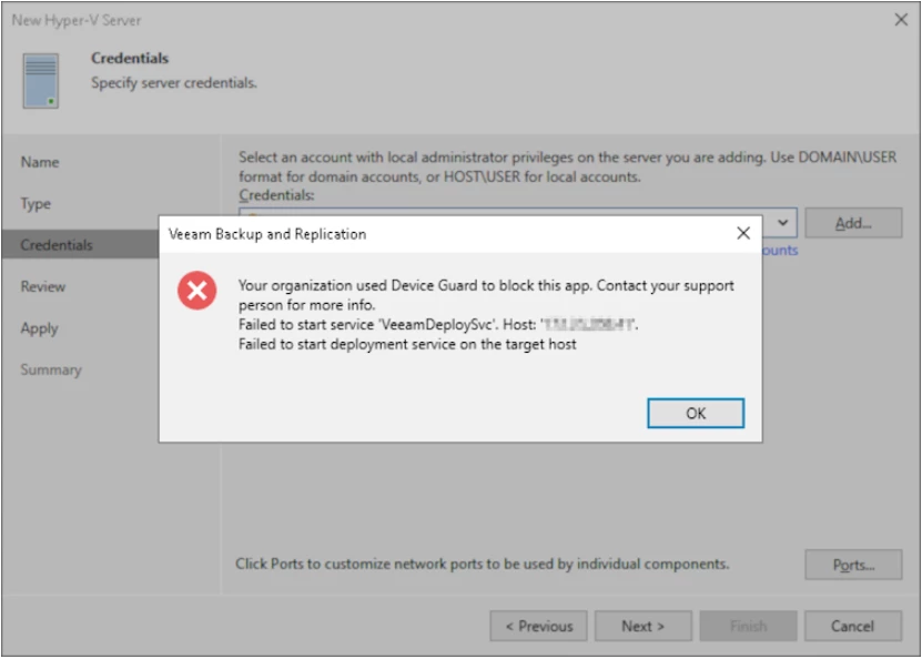

During the process of adding the Azure Local cluster dedicated to the HyperV environment, you will receive the following error.
This is the fix:

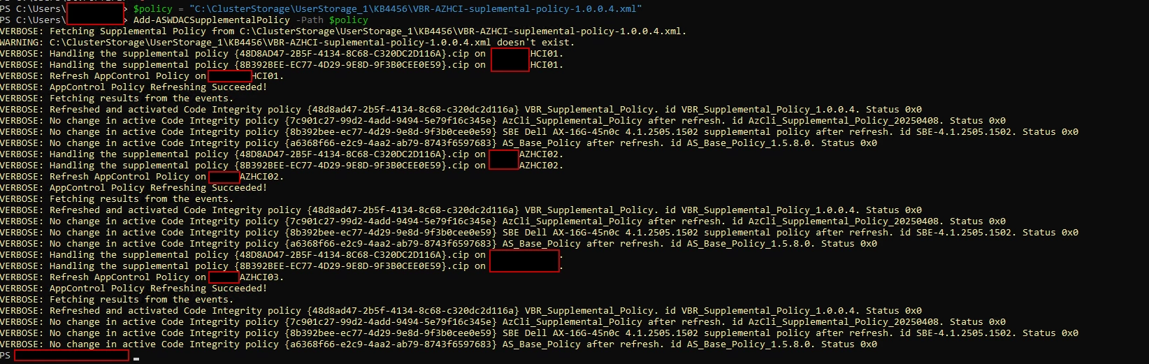

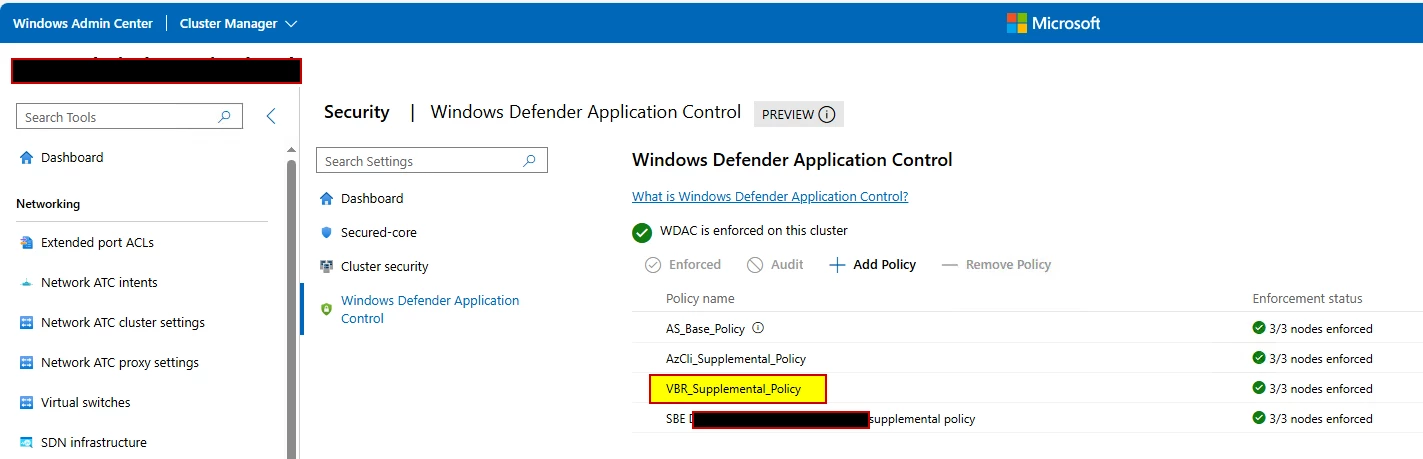

KB4456: WDAC Supplemental Policy for Veeam Backup & Replication Components on Azure Stack HCI
  1. Download & copy the policy XML file to a location on the CSV (Cluster Shared Volume) shared by the nodes.
  2. Connect in RDP on HCI\HyperV host.
  3. Execute command in PS.
$policy = "C:\ClusterStorage\UserStorage_1\KB4456\VBR-AZHCI-suplemental-policy-1.0.0.4.xml"
Add-ASWDACSupplementalPolicy -Path $policy
 Check from the in Windows Admin Center in Cluster manager

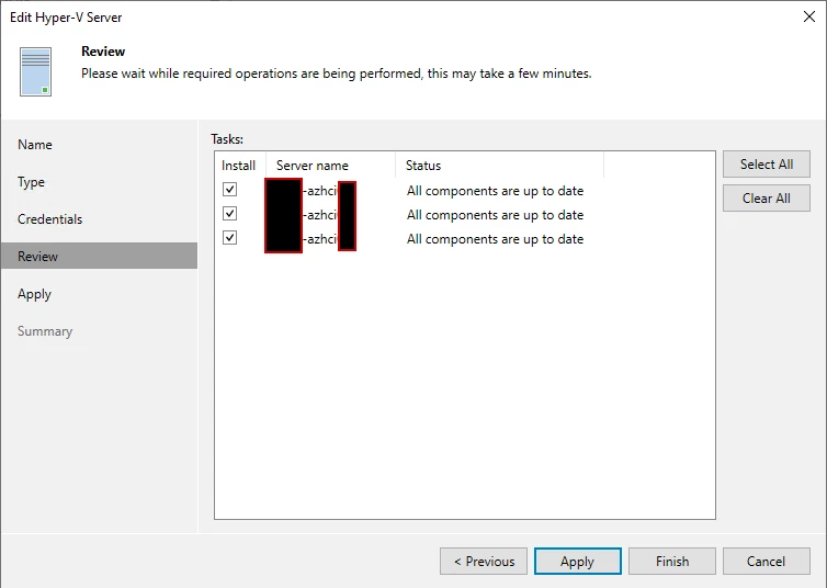

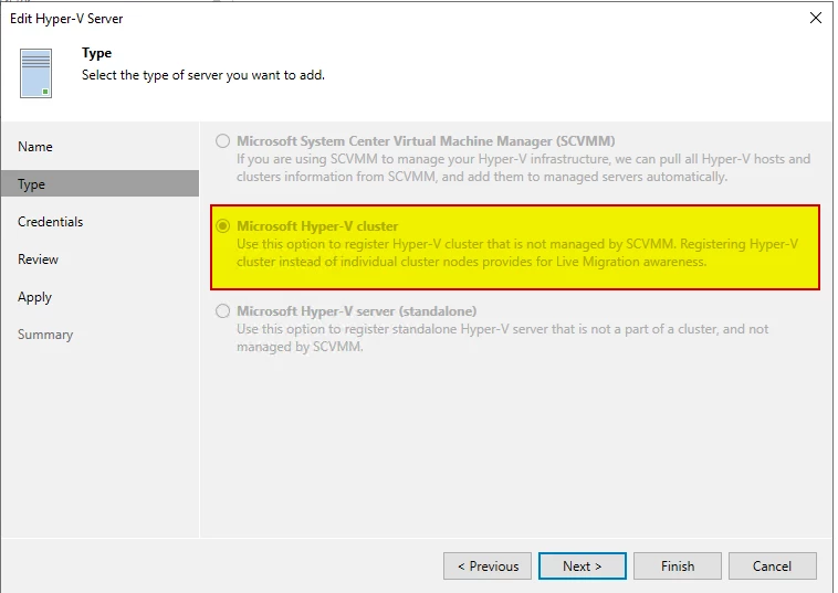

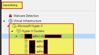

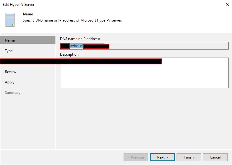

  • Now we can proceed to add the Azure Local cluster to the Veeam infrastructure.

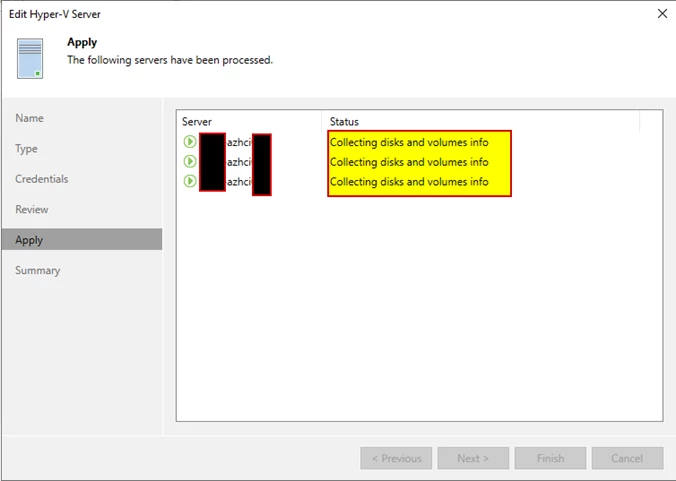

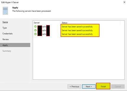

  • Slect HyperV Cluster

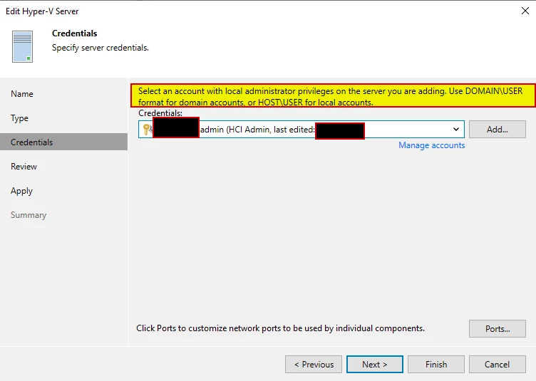

  • Insert user Domain Administrator

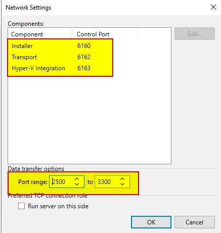

  • Verify port connectivity
  • Review

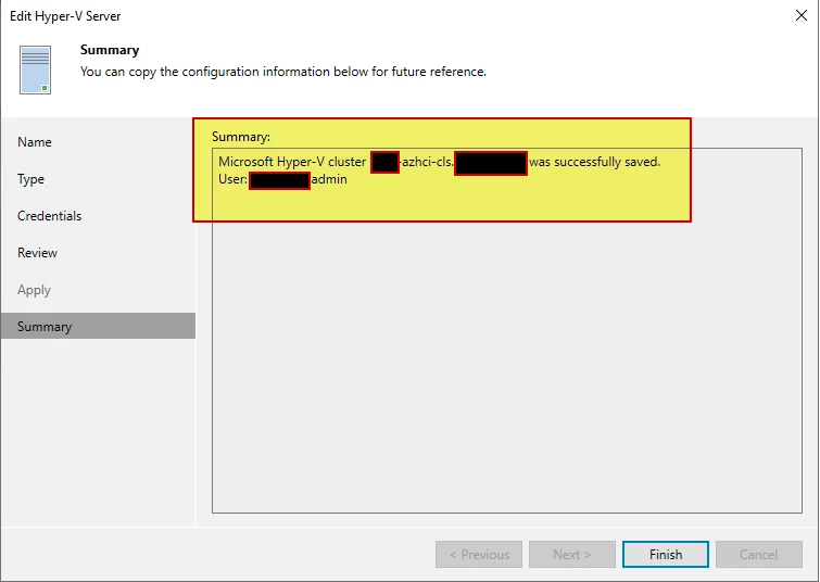

The process has been successfully completed. You can now proceed to configure your backups on Azure Local.

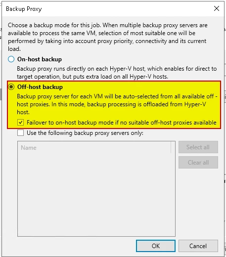

We migrated our entire VMware environment to Azure local. It's important that the backup job uses the “on-host proxy”. While we also have VMware proxies, and the Hyper-V backup job used these proxies, the proxy doesn't have permission on the Hyper-V host. As a result, the checkpoint creation fails, and the VM locks. The only thing you need to do to restart the VM is to restart the host with the entire workload. This has a significant impact on production.
hi ​@Christoswan
we use offhost without any problems
  • New Here
  • July 9, 2025
ok, I guess you don't have proxies in a VMWare environment? The problem exists when you have backup proxies in both environments
  • New Here
  • July 10, 2025
ok, forget what I wrote, the problem still exists
hi ​@Christoswan
Hi, in your backup job logs for Azure HCI VM, does it says “Using source proxy Name (offhost)” ?

Hello ​@Link State,
thank you very much for the step-by-step instructions!
Please note that there is a small typo in the PS command / file name → the file in the downloaded zip archive is named VBR-AZHCI-supplemental-policy-1.0.0.4.xml whereas in the command above, VBR-AZHCI-suplemental-policy-1.0.0.4.xml (missing “p” in “supplemental”) is used in the $policy variable.
With the correct file name, the output of Add-ASWDACSupplementalPolicy looks like this:
(Notice that the line “WARNING: C:\ClusterStorage\UserStorage_1\KB4456\VBR-AZHCI-suplemental-policy-1.0.0.4.xml doesn’t exist.” is gone)
Regards

Hello ​@Link State,
Regards
Thank you for clarifying that.
