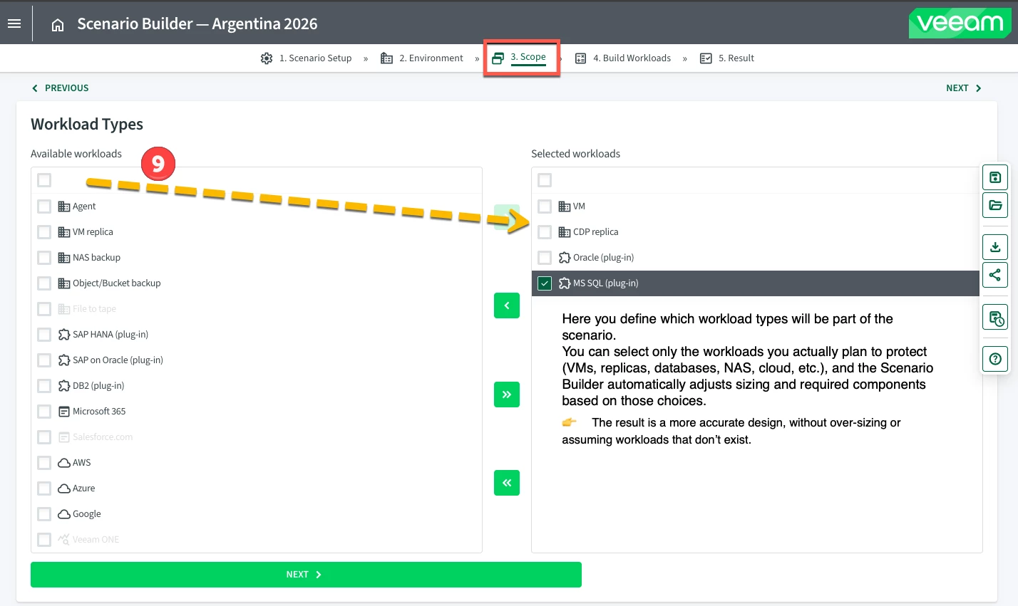

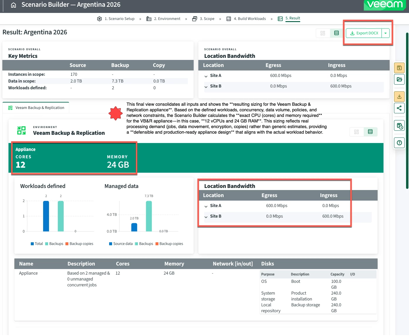

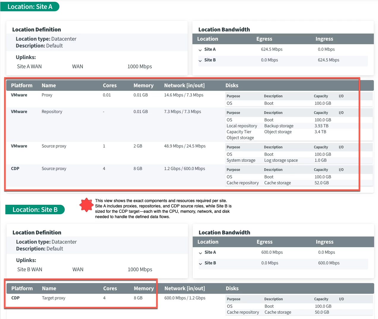

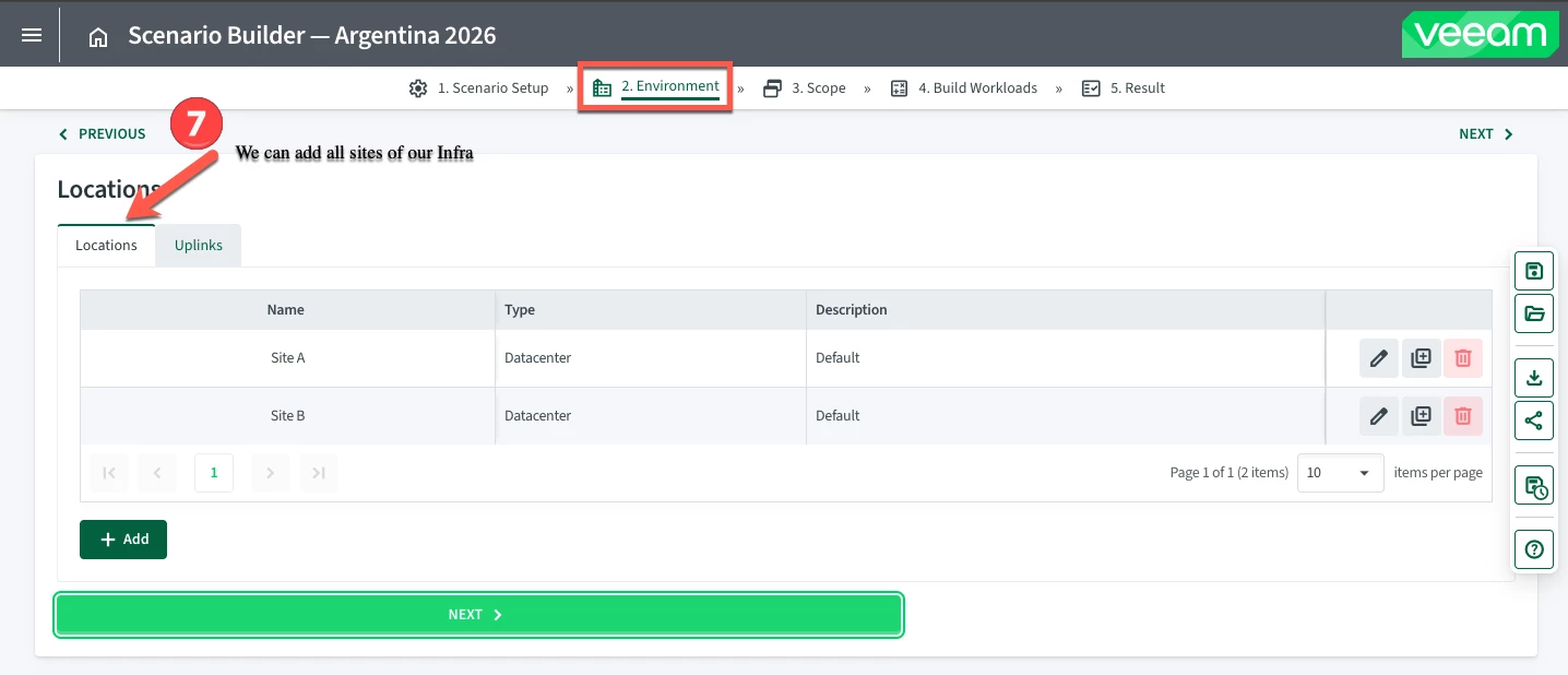

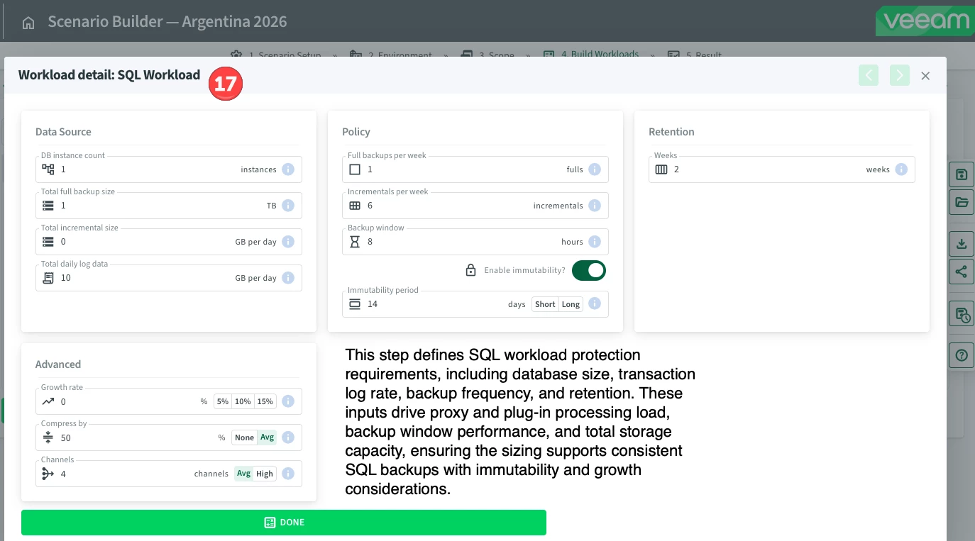

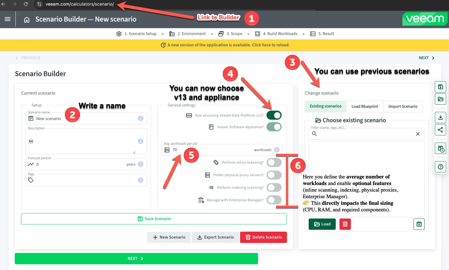

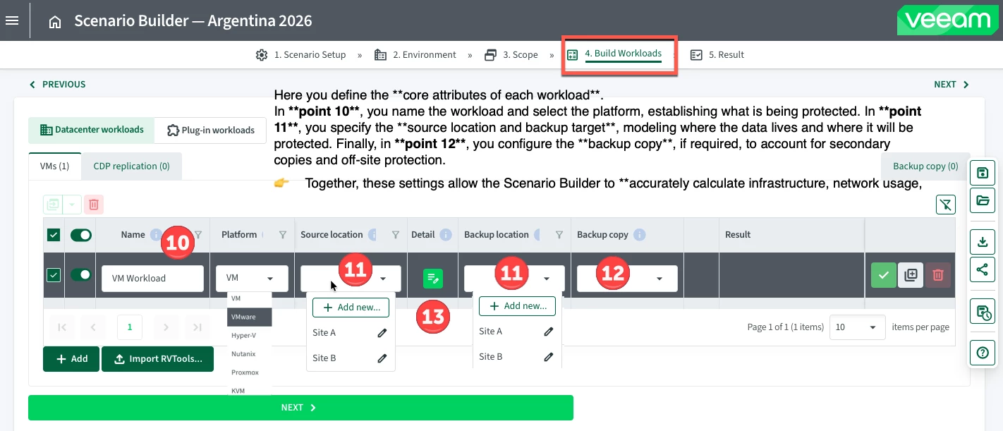

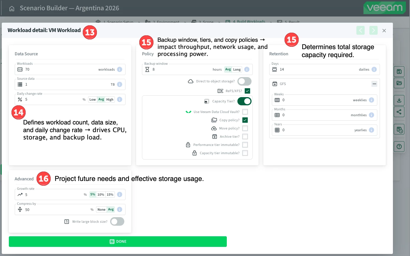

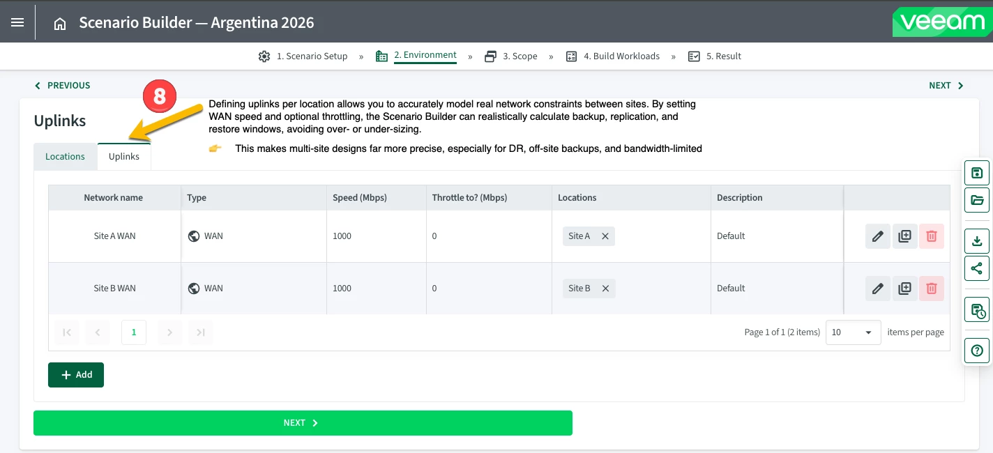

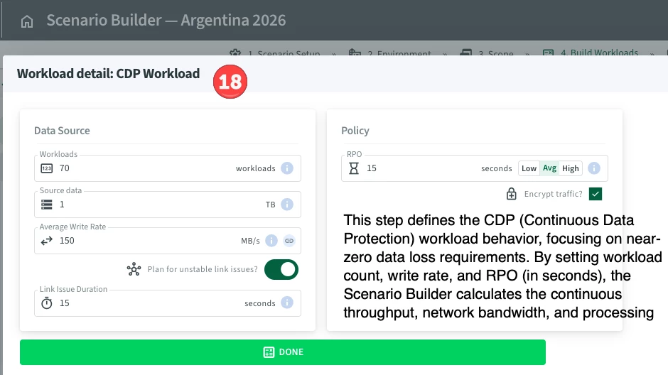

Sizing Veeam environments has always been a mix of experience, assumptions, and spreadsheets. But that just changed. With the new Scenario Builder, Veeam takes a big leap forward, making multi-site sizing clearer, smarter, and far more predictable—turning complex design decisions into a structured, repeatable process.
RESULTS !!!!  😎📊
To wrap it up, the Scenario Builder turns sizing from assumptions into facts. By modeling real workloads, data flows, and site-to-site constraints, it delivers a clear, defensible, and repeatable design for Veeam deployments. Instead of guessing, you end up with a sizing you can explain, justify, and trust—ready for production from day one.
