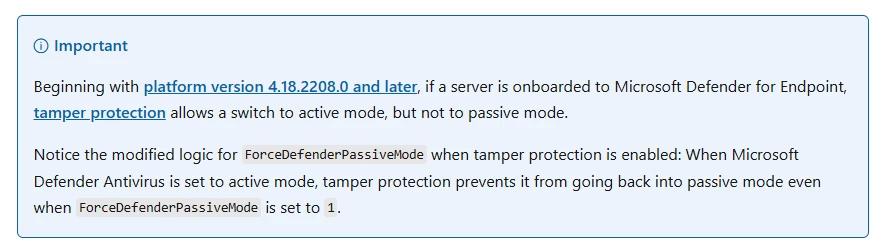

  • August 20, 2025
Hello,
Apparently, the workaround no longer works with newer Defender versions. https://learn.microsoft.com/en-us/defender-endpoint/microsoft-defender-antivirus-compatibility
Best regards,
Heyko
