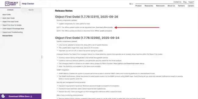

To use Honeypot, a new feature available in Object First OOTBI v1.7. You will have to ensure that you have upgraded your OOTBI cluster to version 1.7.79.12311 according to the documentation. See the release Notes, and you will be redirected to the Request form.

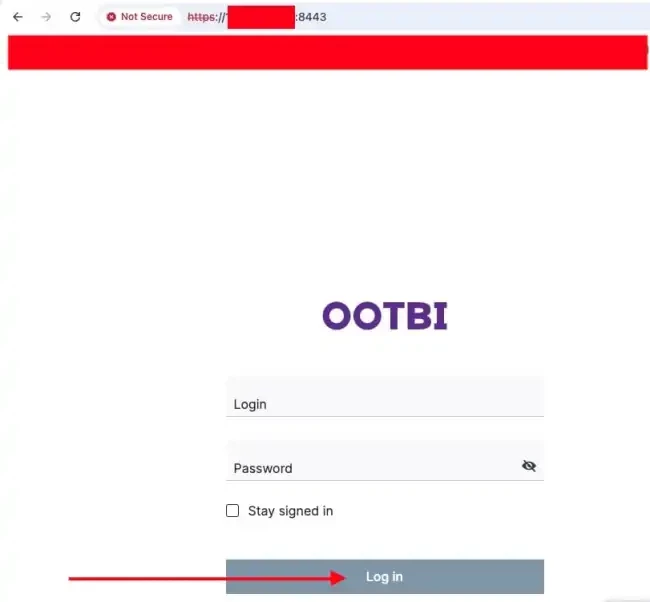

Therefore, this section discusses how to perform an office upgrade of OOTBI to v1.7 as this is not made to all customers as of yet. To do this, logon to the Object First Web UI.

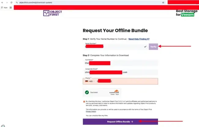

On the release note as attached in the first paragraph, click on Download Offline Bundle for v1.7.
In the Request Your Offline Bundle, populate the form with your information. If you want the approval with the speed of light, contact Object First Support
The form will be submitted very shortly. I got a separate email with a download link.

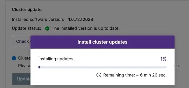

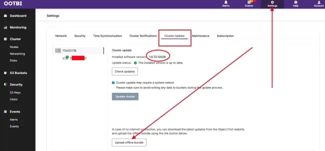

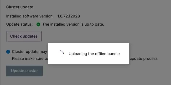

The prerequisite is to ensure that you are running Object First OOTBI (1.5.54.10596). As you can see below, we are already above that and on v1.6. To perform the update, click on “Upload Offline Bundle”.

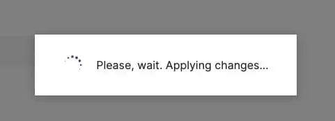

The upload is in progress

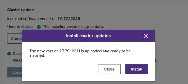

When the upload completes, you will be required to install. Click on install

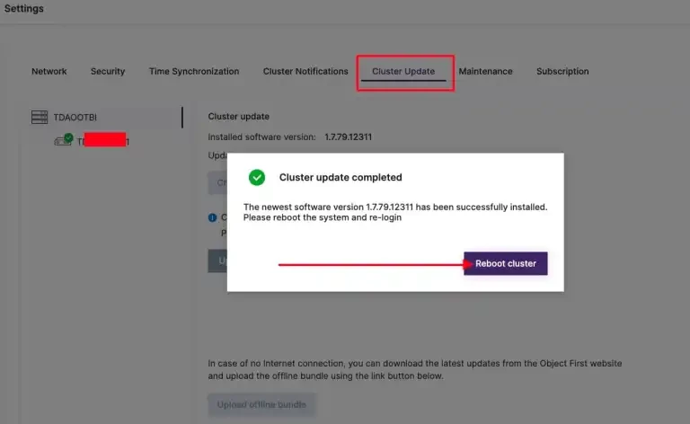

In progress
Update complete. We are now running v1.7

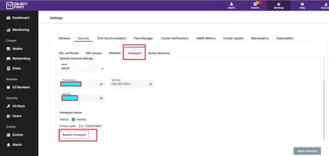

Enable Honeypot

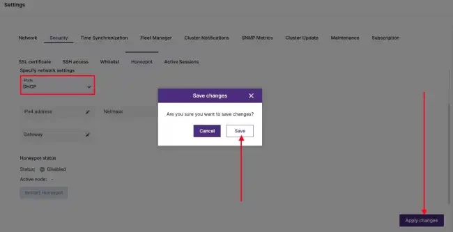

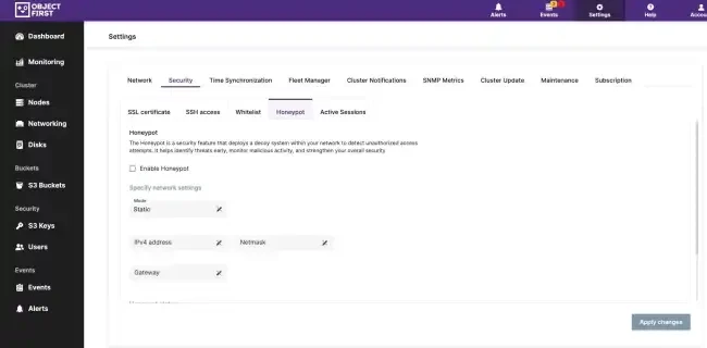

To enable Honeypot as discussed above, it requires only a few clicks. Navigate to the Settings and then click on the Security tab and select Honeypot.
I am fine using DHCP. You can set the IP statically if you want. Do not forget to save when complete.
That is all - You can now simulates various types of attacks and you will be alerted. See this blog on various security best practices.
