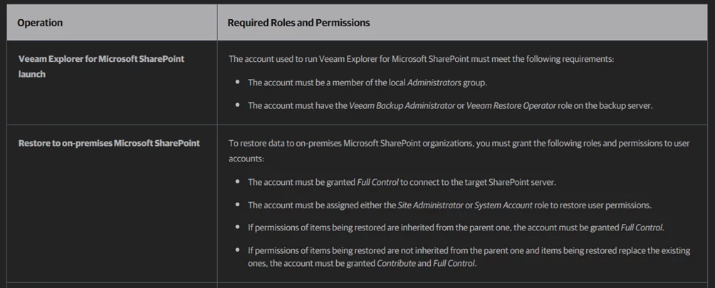

First, you need to consider what permissions are required to use the Veeam Explorer for SharePoint tool:
https://helpcenter.veeam.com/docs/backup/explorers/vesp_permissions.html?ver=120

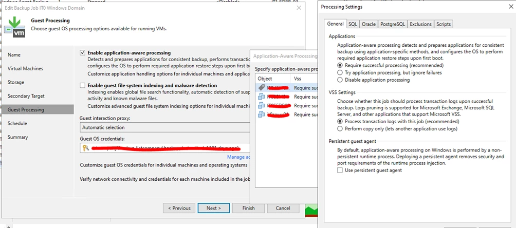

Server backup jobs must have Application-Aware correctly configured:

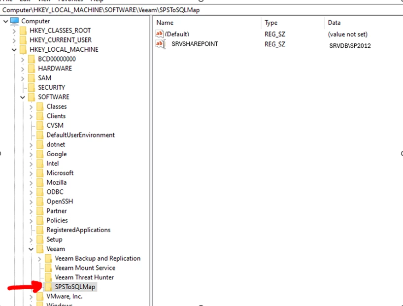

Check the name of the instance on the DB Server running SharePoint and add a registry key on the VBR server and on the VM_MSSQL server.
In our example, we have:
SRVSHAREPOINT: SharePoint server
SRVDB: MSSQL server with SharePoint DB
SP2012: SharePoint MSSQL instance
Registry key needed:
[HKEY_LOCAL_MACHINE\SOFTWARE\Veeam\SPSToSQLMap]
"SRVSHAREPOINT.mydomain"="SRVDB\\SP2012"

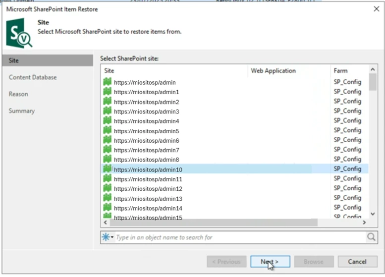

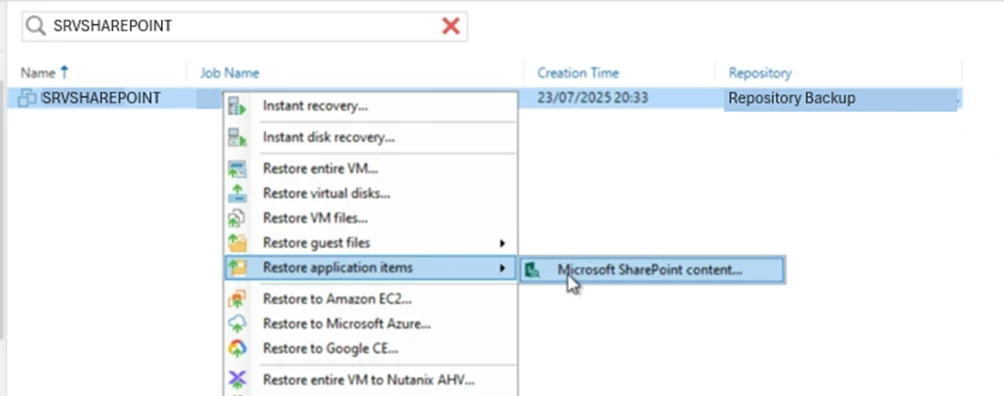

Select SHAREPOINT server and Restore Application Item, Sharepoint:
The procedure opens and I select the site I want to restore:

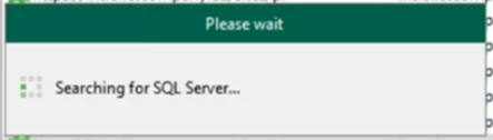

Now it will connect to the DB server that we configured in the registry key…

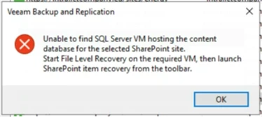

If we have not configured the registry key correctly, we will get this error:

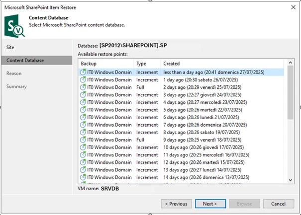

Now choose the restore point:

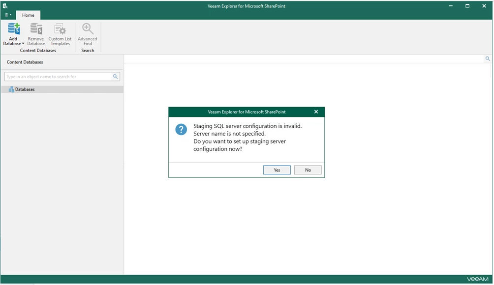

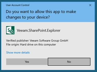

After procedure open Veeam SharePoint Explorer:

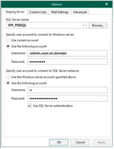

The first time we run it, it configures the “staging server” we are working on:
Enter the required data for the local VM_MSSQL server:
  • Account to connect to Windows server: User with administrative rights on the server and on SharePoint
  • Account to SQL Server Instance: “sa” user configured on VM_MSSQL server

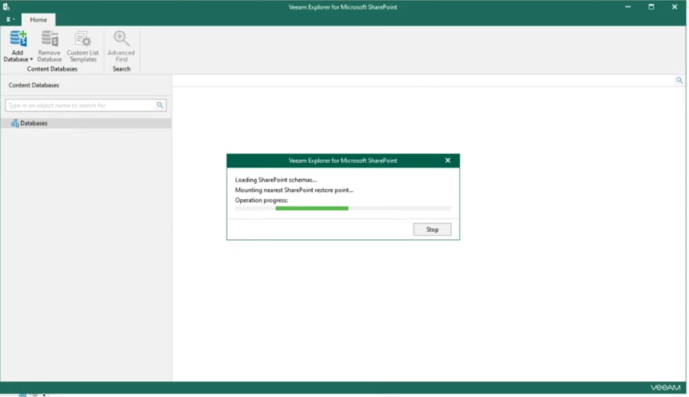

The procedure begins with recovering the DB from the backup and mounting it on the staging VM_MSSQL server:

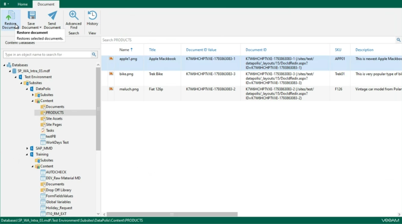

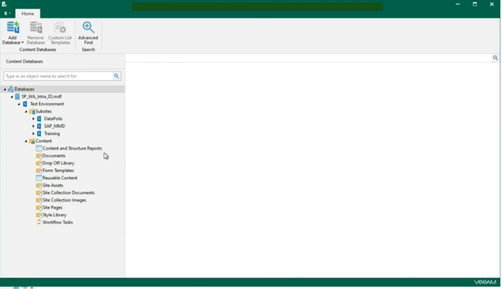

Once the DB has been loaded (the time varies greatly depending on the size of the DB), we obtain the SharePoint site:
…and restore:

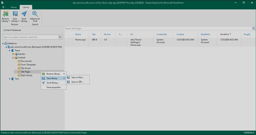

I can save library on files or zip:
Or export it:
