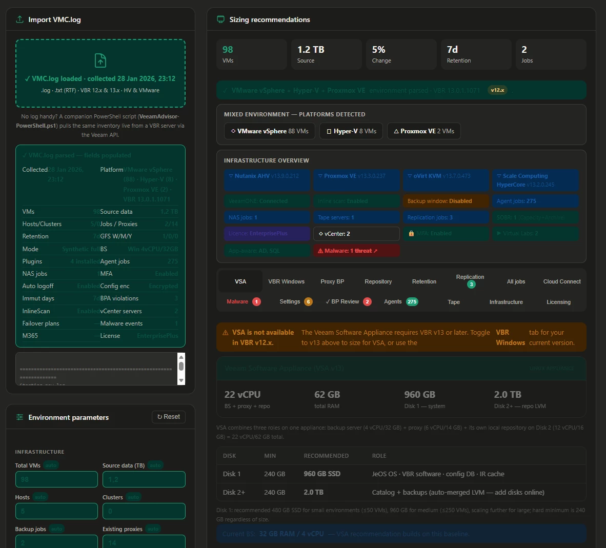

It's called Veeam Advisor. It's a single HTML file that parses a VMC.log and gives you back the environment in a form you can actually use — sizing recommendations, a best-practice review, protection coverage, the lot. It's free, and I'll put the link at the bottom.
One thing I want to mention first, because for a backup audience it's the bit that matters: it runs entirely in your browser. There's no server, no upload, no "drag your customer's infrastructure detail into some random website." The log file is read locally by the browser and never leaves the machine — no fetch, no upload, nothing goes out over the wire.

Drop a log in and it figures out whether you're looking at a Windows VBR or the appliance (VSA), the platform (VMware, Hyper-V, Proxmox, AHV), Cloud Connect if there's any, every proxy with its task counts, repositories and SOBRs, all the job types, replication, agent jobs, GFS and retention, malware/threat events, and the security posture — MFA, immutability, config-backup encryption, and so on. Then it lays it out across a set of tabs and adds a sizing calculator and a best-practice review on top.
How to use it
1. Get a VMC.log. This is the log the backup server produces. Easiest way is to export logs from the console (Help → Support Information), and you'll find VMC.log in the bundle. It's also sitting in the logs folder under ProgramData on the VBR server if you'd rather grab it directly. One thing worth knowing — if you've just created or changed a job, run it once so it has a restore point before you export, otherwise the freshly-made job won't show up in the collection yet. (Learned that one the hard way.)
2. Open the tool and drag the log onto it. That's genuinely it. The drop zone is the big box in the middle. It parses in a few milliseconds — even a 4MB log is basically instant, because nothing's being uploaded, it's just reading off your disk.
3. Read the tabs. A few I find myself using the most:
  • BP Review — the compliance findings, sorted by severity. This is usually the first place I look. It'll flag things like no backup copy job (3-2-1 not satisfied), no SureBackup, MFA off, immutability not set.
  • Protection coverage — compares the VMs it can see in the infrastructure against what's actually covered by backup jobs and agents, and gives you an estimated unprotected count. Big caveat on this one, see below.
  • Tape — if there's tape, it shows you what's there (servers, drives, libraries, GFS vs regular media pools). If there isn't, it'll size a GFS tape job for you across LTO-7/8/9. It uses native capacity, not the compressed marketing number, because Veeam backups are already compressed and you get basically nothing from tape hardware compression on top — a detail that trips people up constantly.
  • Infrastructure — a one-screen inventory of the whole environment mapped against the Veeam best-practice design areas. Handy for "what am I even looking at" before a call.

Reading the log is half of it. The other half — and the reason it earns a spot in my bookmarks rather than being a one-off curiosity — is that once a log is loaded, every sizing input is editable, and the recommendations recalculate off whatever numbers you put in.
When you drop a log, it pre-fills the inputs from what it found: VM count, data size, host and cluster count, job count, retention, GFS, NIC speed, existing proxy count. But none of those are locked. Change any of them, hit Calculate, and it works the sizing again. That turns it from a viewer into a planning tool, which is where the real conversations happen:
  • Proxies. It works out how many backup tasks your data volume needs to fit the backup window over the NIC you've got, then how many proxies that takes (it sizes virtual proxies at 6 vCPU / 14 GB, capped at 12 tasks each), and compares that against how many are actually deployed. So you can sit there and go "right, what if the customer doubles their VMs?" — bump the VM and TB figures, recalculate, and watch the proxy count and the per-proxy vCPU/RAM move. Or "what if we shrink the backup window from 8 hours to 4?" — same thing, you immediately see whether the current proxies still cope or whether you're adding iron.
  • VBR server CPU and memory. The backup server sizing scales with concurrent jobs (it works on roughly a core and a few GB of RAM per ten concurrent jobs, on top of a base), and it takes the detected server spec as the floor. Add jobs, or grow the estate, and you can see the point where the current VBR box runs out of headroom and needs more cores or RAM — before it becomes a 2am problem rather than a planning one.
  • Repository and growth. Same deal — change retention or GFS or the change rate and the capacity figure and the storage-growth projection move with it.
That's the bit I find genuinely useful for partner conversations. Instead of "here's what you have," it's "here's what you have, and here's what happens to your proxy and backup-server sizing if you grow the way you're telling me you're going to." You're modelling the impact live in front of the customer instead of going away to build a spreadsheet.
It also works the other direction — you don't need a log at all. Type the numbers straight in and it'll size a greenfield environment for you.

Just ran it against an old VMC.log from my lab (prior v13 conversion):
