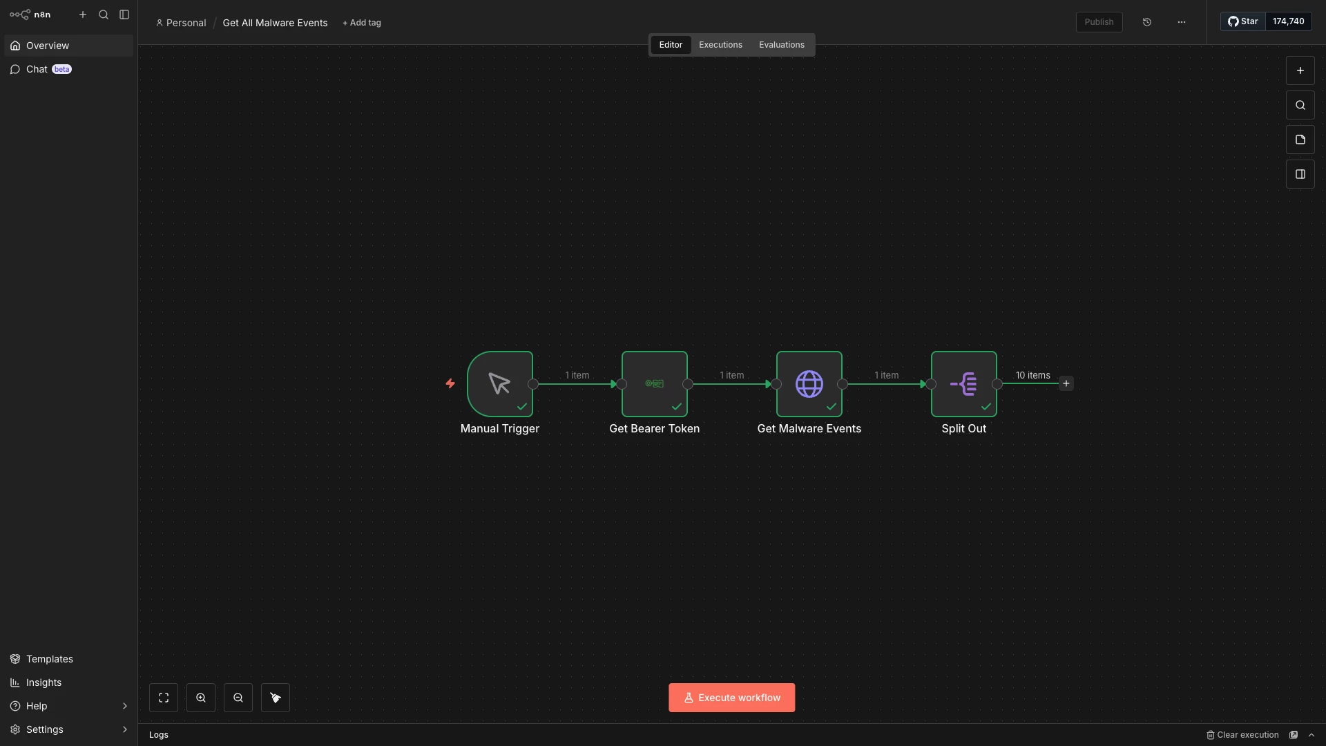

This integration consists of two main components: A Custom credential type and a Veeam Get Access Token node. The custom credential allows you to store your VBR REST API endpoint, the revision level, and authentication details. At the same time, the node generates the Bearer token and passes everything you need for subsequent REST API actions (Access token, base URL, and API version).
With this, you can build workflows using the n8n standard HTTP Request node to interact with the Veeam REST API.
Get All Malware Events Workflow
I also created some sample workflows that demonstrate practical use cases from simple status checks to specific actions. These will be shared alongside the integration files to help you get started quickly.
Everything can be found in my GitHub Repository.
