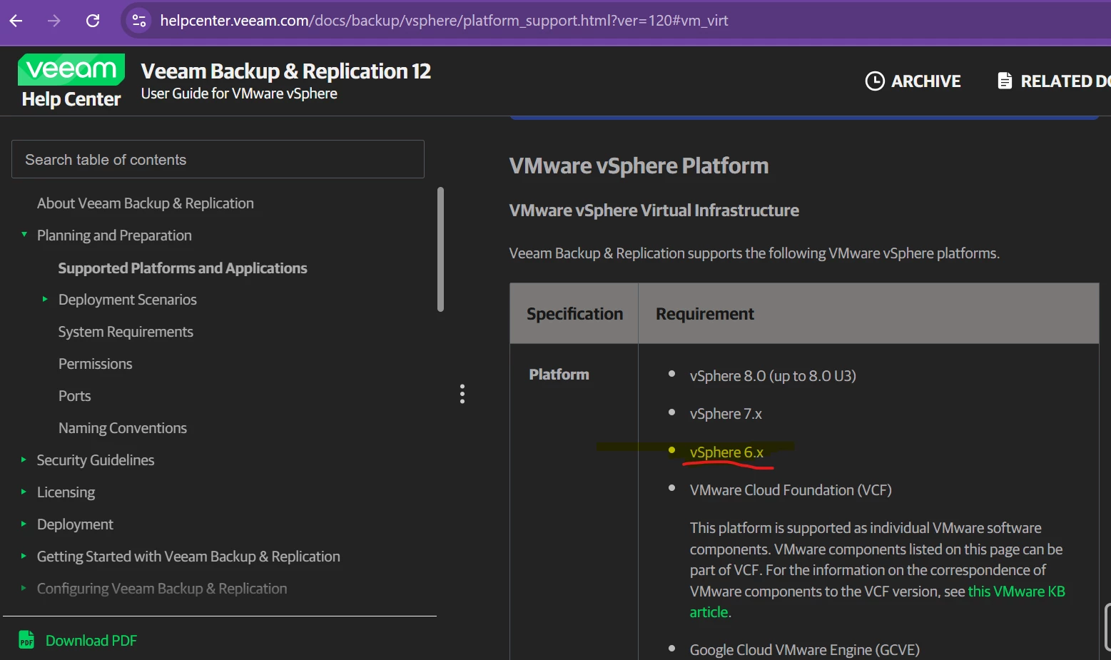

Hi ​@atinivelli Veeam v12 supports vSphere 6.7, but vSphre 6.7 in not under support bt Broadcom anymore. https://knowledge.broadcom.com/external/article/318381/announcing-end-of-support-life-for-vsphe.html
https://helpcenter.veeam.com/docs/backup/vsphere/platform_support.html?ver=120#vm_virt
So, I think is better to convince the customer to upgrade to vSphere v7
