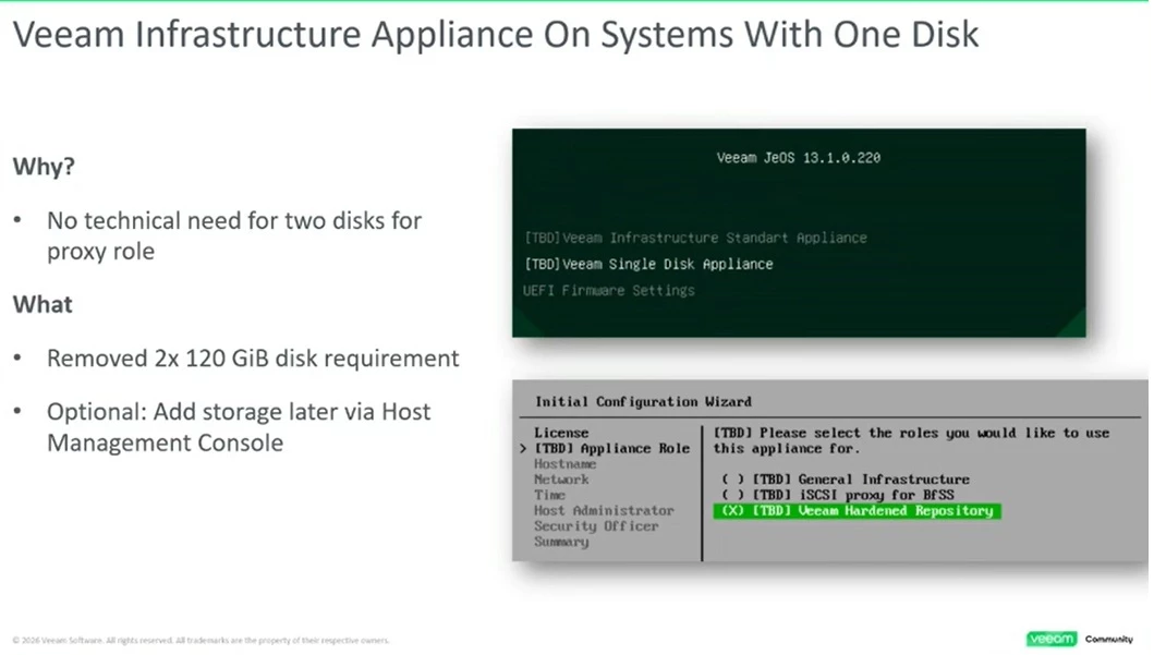

A quick follow up :
v13.0 => Because we are deploying v13.0 we had not other choice that adding 2xdisks in an other Raid1 Group for the DATA requirements.
v13.1 =>
I understand that this problem is going to be solved in the 13.1.0.220 version of the VIA where this limitation to two disk 2x120Gb has been removed, and optional storage will be possible to add via Host Management Console.  Not sure if it’s going to be the same for the VSA though.

Je te confirme que la 13.1 retire la contrainte des deux disques.

Just a side note. The disk requirement for the VSA didn't change with 13.1 as it still requires two disks.
