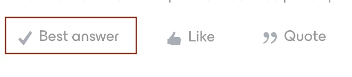

Hi ​@sumit.saini - please click the Best Answer icon under the Comment already posted if any helped you.
Mark as Best Answer
