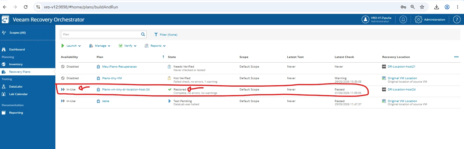

Hi Heroes, hope you all are good.
I’m using VRO 7.2 , I have  executed a recovery plant hours ago, but on recovery plans steps it shows in-use, but the recover worked.
Does anyone have an ideia why it still in-use?
If I reset it, it will be OK,

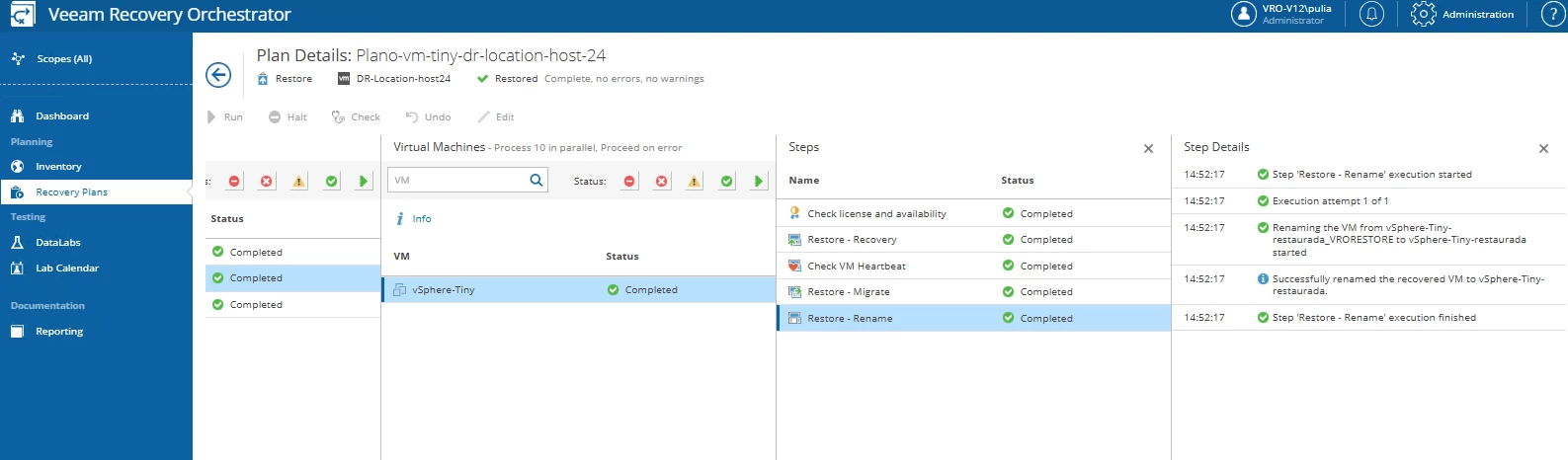

Hi ​@AndrePulia , you should reset the plan (after reviewing what happened in Plan Details view!)
​VRO retains the in-use status until you reset, the main reason being - if we reset the plan (back to Enabled status) the moment it was finished - then all the records in Plan Details would be wiped. The instant that the plan finished, we would remove all the history of what happened!
You could go to the VRO reports page and open the report with the same info of course! But it seemed more convenient to hold the plan in “in-use” status so you can see all the results for every VM and step.
If you are finished reading the output, then just Reset the plan and it will be ready to restore again.
