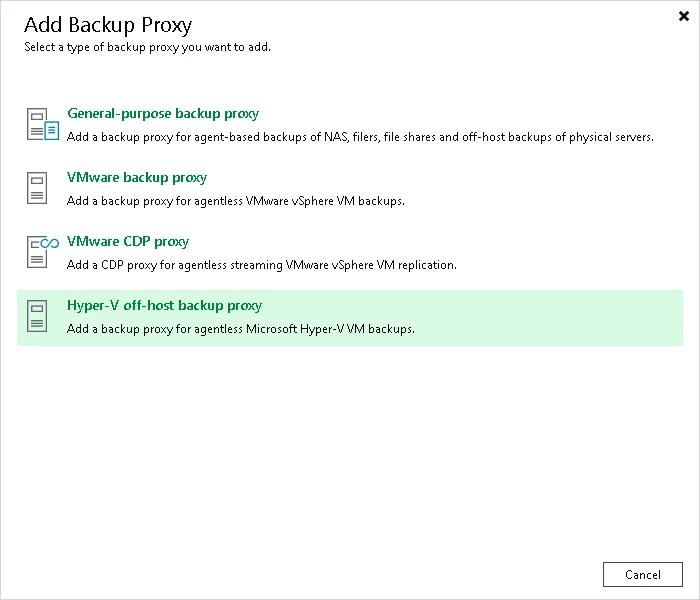

Add additional backup proxies
Remember that your Veeam Backup & Replication server is already a proxy server by default. At this point, you may not need to add an additional proxy.
Pro tip: You should consider checking that your Veeam Backup & Replication server has 8 core and 16GB of memory or creating a dedicated Windows or Linux proxy server. When you start sizing Veeam for your entire environment, you can adjust these resources as needed.
Adding proxy using Console
Adding proxy using Web UI
A specific VMware proxy is required to back up production data via (Network or HOTADD) Transport modes.
