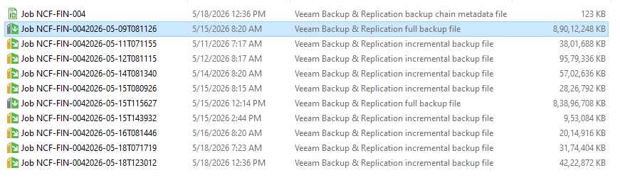

Hello Team,
I am using Veeam Agent / Veeam Backup and Replication for backup storage on a NAS.
I noticed that in my backup repository folder, Veeam creates:
  • .VBK full backup files
  • multiple .VIB incremental backup files
  • .VBM metadata files
My question is:
Why are there multiple .VBK files stored in the same backup folder?
Are these incremental restore points expected behavior?
Also:
  • Will Veeam automatically delete old .VBK and .VIB files according to the retention policy?
  • Is it safe to manually delete multiple or older .VBK files from the repository folder if storage becomes low?
  • How does Veeam manage the backup chain cleanup process?
I want to better understand how Veeam handles incremental backup retention and storage management.

Hello, I would like to express my concern regarding my ability to configure synthetic full backups or forward incremental backups within the application I am currently using. I suspect that my lack of permission to access these features might be the reason I am unable to find the relevant settings in the free software I downloaded from the Microsoft Store. Could you please confirm if this is the case?
  • Author
  • Not a newbie anymore
  • May 23, 2026 6:14 AM UTC
What I seek is this forward incremental backup: I believe my backup process is a synthetic full backup. How can I set up a forward incremental backup?
Forever Forward Incremental Backup

​@coolsport00 This is what I have in my advanced button > Backup tab, so how can I configure the forward incremental backup?
coolsport00
Forum|alt.badge.img+23
  • Veeam Legend
  • Answer
  • May 30, 2026 11:27 AM UTC
Hi ​@Esayas.T - Ok...so just enable the Active Full option. It appears the Windows Agent for Free doesn’t have the Synthetic Full option. Once you enable the Active Full option, just configure the day/date you want it to run. It’ll run on the day you configure at the time you configure your Job to run. You will then have a Forward Incremental method configured.
Keep in mind though...the screenshot you shared a few comments ago is not of a Forward Incremental, but of a FOREVER Forward Incremental, where your Job creates a Full on the very first Job run, then only Incrementals are created every Job run after. A Forward Incremental does the same thing, but has the Incrementals are broken up by running an “occasional” Full (Synthetic or Active, but in your case it appears only Active can be run). The KB1932 I shared earlier explains this behavior real well.
