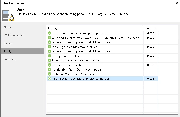

Hi,
I am setting up a Linux Hardened Repository for our backups and have followed ​@HannesK ‘s very good instructional videos found here: https://www.veeam.com/blog/rocky-linux-veeam.html
I got everything done on the setup of the Rocky Linux machine, however I cannot get it added into Veeam Backup an Replication Console.  It gets stuck on this part
 It is exactly the same error as this forum post however, I am not being successful
What I have tried so far:
I have disabled the firewall on the Rocky Linux machine:  Same error
I have added the user to the Wheel Group to give it Sudo permissions: Same error
I have as suggested in that link chose the less secure linux and not one-time password option… which then gives me the error same as this. https://forums.veeam.com/veeam-backup-replication-f2/problem-setting-up-linux-repository-t75144.html
The setup is Veeam Version 11 latest build P20240304
Rocky Linux 9.5
I would appreciate any help that anyone can give me to try.

Hey, for a good Guide you can follow the steps here on the blog from ​@PeteSteven
But also the blog from Hannes should work ;)
https://petersvirtualworld.de/veeam-veeam-hardened-repository-installation-with-rocky-linux/
Regarding your Veeam Version - you have to upgrade! Not especially because of this error, but please go to latest 12.3 Version (with additional step over 12.0) and try again. There are a lot of improvements in 12.x and also a lot of security fixes.
Matze
matheusgiovanini
Forum|alt.badge.img+12
As far as I remember, Rocky Linux 9.4 is not officially supported with Veeam 11a either.
However, is the SSH service currently running?
You might also consider checking the possibility of upgrading Veeam to a version that officially supports Rocky Linux.

I agree with Matheus and suggest updating to Veeam v12 before further troubleshooting. This will also be required before you can open a support ticket since v11 is out of support.

agree with all steps above, but also think about using the Veeam Hardened Repository ISO (instead the manual way with Rocky) - this would make it a lot easier, compared to manual deploying a Rocky, Hardening with DISA/STIGs, etc…
Preparing Hardened Repository Using Veeam ISO - User Guide for VMware vSphere
This would be my suggestion along with everyone else that said to upgrade to the latest 12.3 release.
